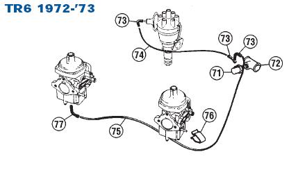

74 with a vaccum advance ? Never heard of that. The last TR6 that had a Vacuum Advance was in 1971 and it had both a Vacuum Advance and Vacuum Retard.

"74 with a vaccum advance ? Never heard of that. The last TR6 that had a Vacuum Advance was in 1971"
My 73 has a vacuum advance and as far as I know, it is the original distributor.
Sam
Re: Very slow in first when letting up on the clut
If the module you're talking about is on the cockpit side of the distributor, it's a Vacuum Retard.
The distributors (pre 72) that had a Vacuum Advance also had a Vacuum Retard.
The Advance was on the radiator side and the Retard on the cockpit side.
:iagree:
From 72-onwards, the US-spec TR6 only had vacuum retard.
