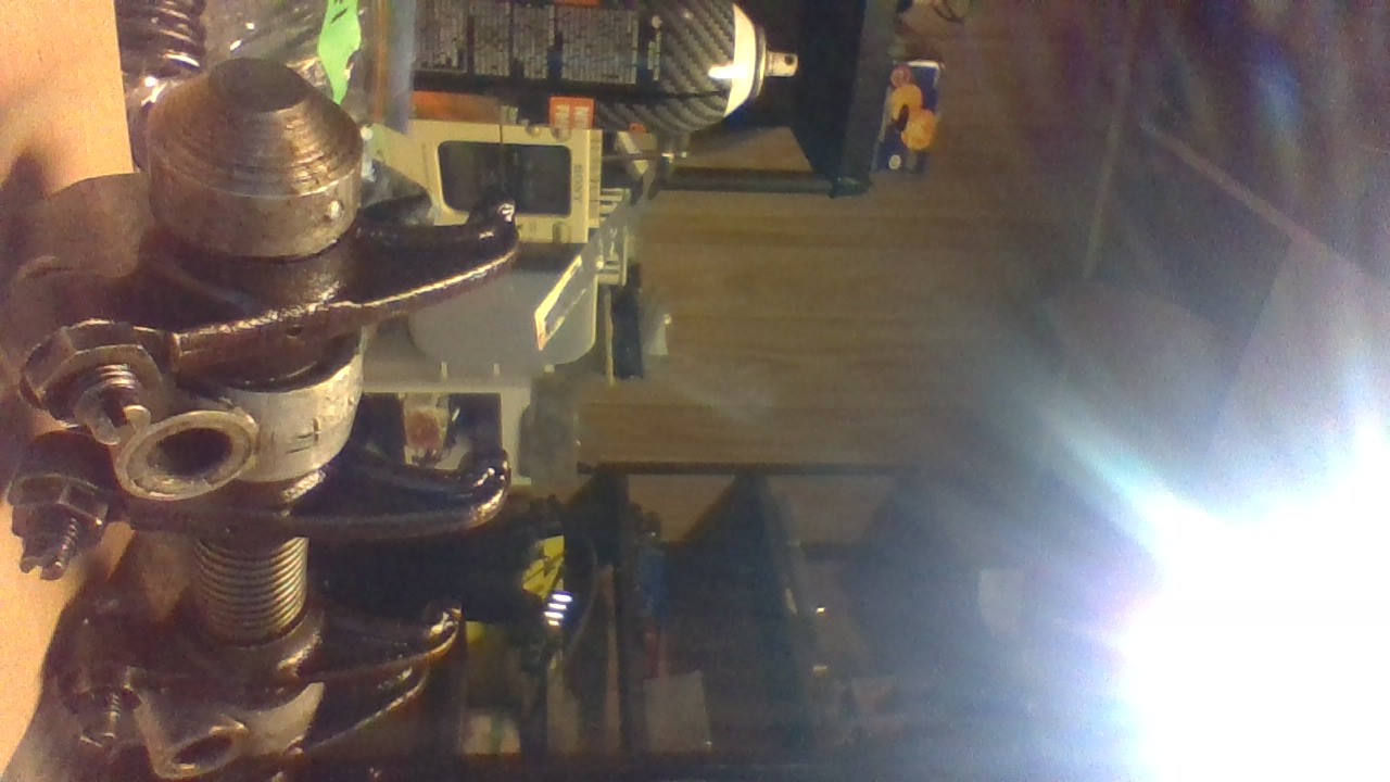

Thinking about replacing the worn rocker shaft. Looks like a very small pin holds the end collar on. How difficult is it to drift out that pin seeing as how the collars are N/A I don't want to bugger them up?
Also I noticed that the lock nuts on top of the pedestals look like they are gouging into the pedestal tops? Is this why they went to flat washers for the TR4 heads? Would it do any harm to use flat washers below the lock nuts or does that throw out the spec somehow?

The caps have a taper pin, so just be sure to tap in the right direction and they will drive right out. Always use washers over aluminum parts.

Do you think the deep wear on the top of the pedestals from the iron lock washers was the reason Triumph put flat washers there for the TR4 cylinder heads? Yes, I bet a new rocker shaft remedies the sticking rockers without even replacing the rocker bushes.

There are aluminum pedestals and cast iron. I would recommend lock washers with the cast iron pedestals, and flat washers with the aluminum. In general, if you are going to use lock washers with aluminum parts, then use BOTH a flat washer against the aluminum, and then the lock-washer on top of the flat washer. Do not use a lock washer against an aluminum part. Triumph very well may have violated this rule during production!?!
Yes it makes sense to have a flat washer underneath the lock washer.The pedestals here are "aluminum". Maybe the PO installed them without the flat washers? Looking at the Moss catalogue the TR4 heads only had a flat washer there. Maybe that's when the pedestals switched from cast iron to aluminum? Maybe I dont need lock washers there at all?:unsure:

Karl, I think Triumph did use lock washers on aluminum pedestals, as most of the ones I have seen are gouged badly. I am just saying that I would recommend using flat washers. The lock washer is optional, as, if you think about it, for a split lock washer to work, the nut must come loose first! When the nut is tight, it cinches the split closed, so there is no locking force...until you go to loosen it. If you torque the nut properly, the lock washer is redundant. A properly torqued nut/bolt that is not overloaded will not loosen on its own.
