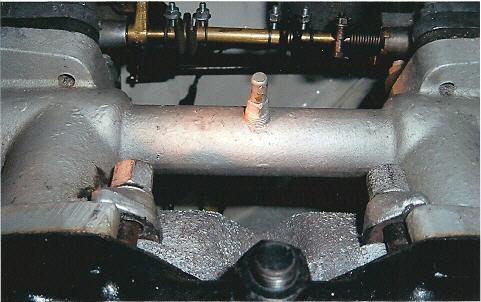

Can someone tell me where to attach a vacuum gauge when testing a TR3?
smilie in place of the real @
What you want is intake manifold vacuum. That looks like a good spot.PatGalvin said:Would this be the recommended location for installing a vacuum gauge fitting? Any thoughts on that? Thanks.

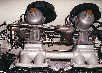

tinman58 said:If you buy the Moss supercharger it already has two ports installed for you. Just a thought....
Darrell_Walker said:Yep, that was the selling point for me! Of course, you need a vacuum/pressure gauge...

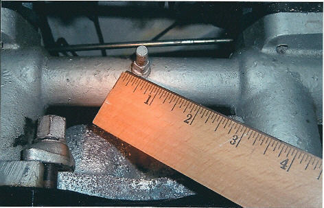

TR3driver said:Yup, good spot. 3/8 NPT is huge, though, I used 1/8 NPT instead.

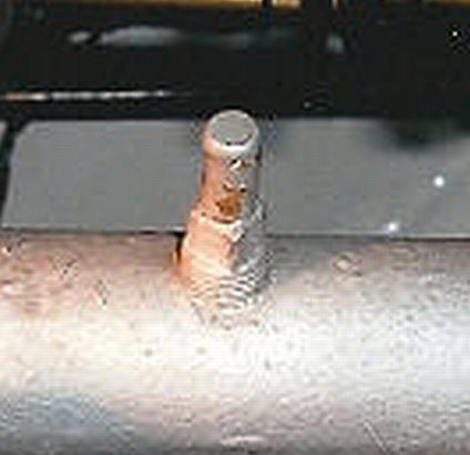

Here's a closeup of Ed's plug, where the threads at the base are more visible.
