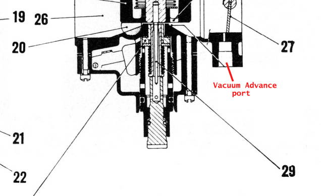

The vacuum advance line from the distributor should definitely be connected to the carb.
The only port that I'm aware of on the intake manifold is the one for the PCV valve in the crossover. Although I've got SU carbs on both of mine, the intake manifold should be the same and you can see the connections in the picture below. Note that on the SU's the vacuum advance port is on top of the front carb where it sounds like it's on the bottom of the Strombergs.
