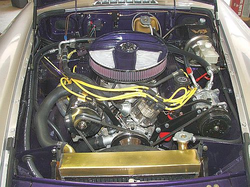

Forgot to add the shot....as you can see, you have plenty of room!

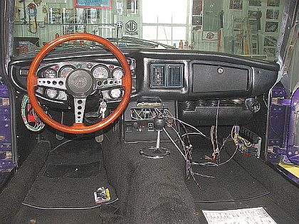

Yes....I installed the combo unit. It is tight under the dash...but plenty of foot/leg room once installed.

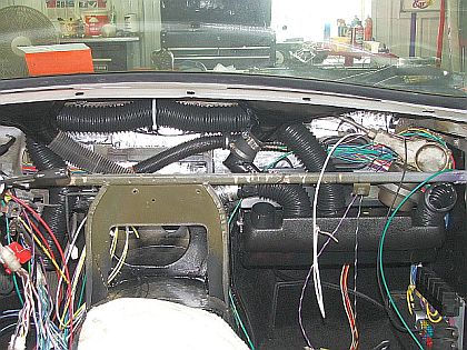

Mickey...here's how I routed the vents to the defroster tubes and the a/c vents.
I sacrificed one driver side dash a/c vent to supply air to the defroster tubes.
I have ducts going to the driver footwell, to one of the middle dash vents, and to the left side of the dash for the passenger.
