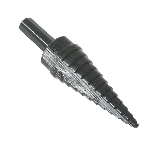

not exactly visualizing but if it works try a step drill - soooo much better. Harbor Freight has them cheap.
Ok got it drilled, forgot the part with using a drop of oil. Tomorrow my plan is to hook it up then the throttle then reverse the radiator fan direction, Blowing forward is of no use. Then a bit of a test drive. I know I will have to get the kick down cable linkage adjusted.
