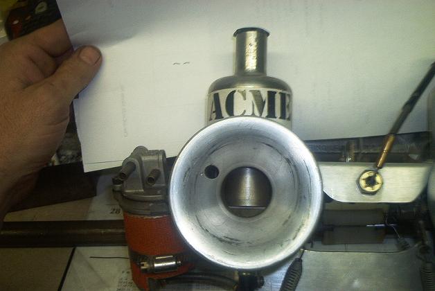

The neat about making like the MGB stack that I mod is when you slip the KN unversal cone filter over with the supplies camp, you don't have two bolt passing thru the airflow. I'll try to post pics to day at the shop of some I made, and some Huffaker made, it's a very simple, user friendly design, that produce the most flow.

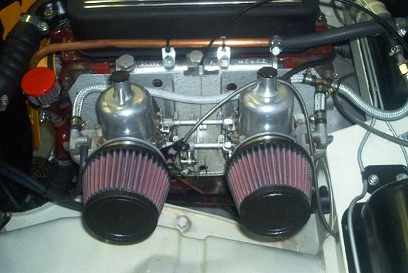

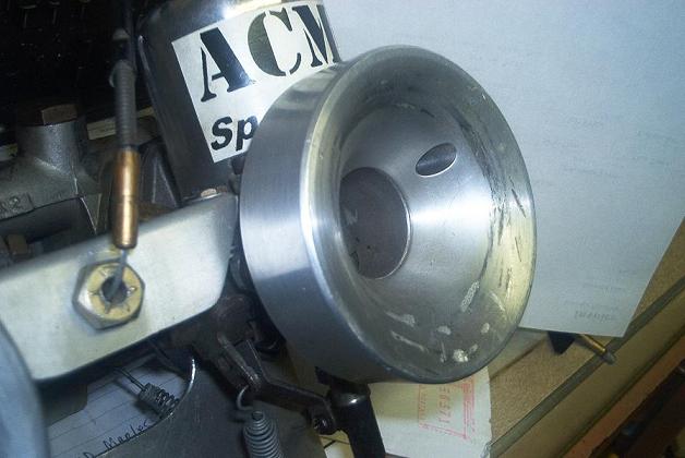

Thanks for reminding me, I almost forgot, until you jogged my memory /bcforum/images/%%GRAEMLIN_URL%%/smile.gif Forgive the scratches on the velocity stacks that came form using those motorcycle foam filters with spring inside of them, if you use the universal cone K&N filters #RU-4410 that works better, here's a picture on a set of the K&Ns on my MGB. You need to make the veloctiy stack 3.5" in diameter for these filters

Aha! The part number works in searches too!
So - any great ideas how to adapt this to the stock velocity stack?
I don't have access to a machine shop /bcforum/images/%%GRAEMLIN_URL%%/frown.gif
I tried to come up with a way to attach a K&N to the stock stack, Moss 372-425 or 372-405, but was not succesful.

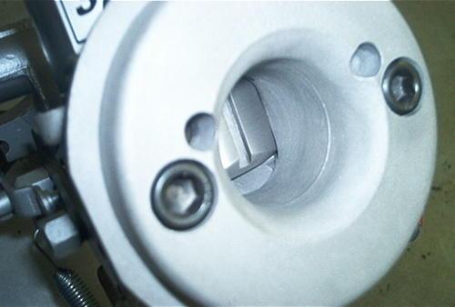

The bottom picture is a MGB engine, and yes those are the stock velocity stacks, only mod is counter sinking the front tow mounting hole to use flush hardware, it's truely a shame all LBCs didn't come with simular set up. Here's a close up of the stock MGB velocity stack with the flush mounted hardware, the factory should have done it this way to begin with /bcforum/images/%%GRAEMLIN_URL%%/smile.gif You'll notice with the above custom made HS2 stacks we widened the radius leading into the carb, which is a good thing.

Thanks Hap - that would be easy enough for me to do with a drill.
How do you hold the filters on at the base?
The picture looks like there is a large compression ring there?

I got them today, $52 shipped.
They look sweet on there, and they make the car sound and drive different. An improvement for sure!
