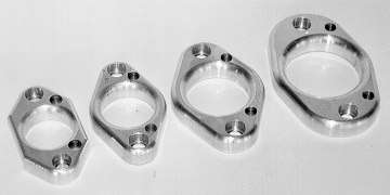

Thanks for reminding me, I almost forgot, until you jogged my memory /bcforum/images/%%GRAEMLIN_URL%%/smile.gif Forgive the scratches on the velocity stacks that came form using those motorcycle foam filters with spring inside of them, if you use the universal cone K&N filters #RU-4410 that works better, here's a picture on a set of the K&Ns on my MGB. You need to make the veloctiy stack 3.5" in diameter for these filters

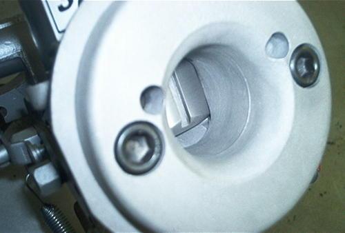

The bottom picture is a MGB engine, and yes those are the stock velocity stacks, only mod is counter sinking the front tow mounting hole to use flush hardware, it's truely a shame all LBCs didn't come with simular set up. Here's a close up of the stock MGB velocity stack with the flush mounted hardware, the factory should have done it this way to begin with /bcforum/images/%%GRAEMLIN_URL%%/smile.gif You'll notice with the above custom made HS2 stacks we widened the radius leading into the carb, which is a good thing.

Thanks Hap - that would be easy enough for me to do with a drill.
