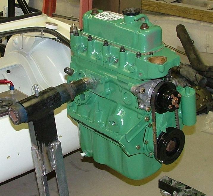

When I assemble my engines I move the timing mark to the top at about 10 or 11 o'clock. I weld on a L shaped piece of sheet metal with one side of the L ground down to a point. After finding TDC for timing the cam I put the timing chain cover and dampener on and mark the dampener. Then I remove the dampener and cut a grove it it with a hack saw. I use the hack saw because I get better control for the initial cut than I do with a reciprocating saw. Once the grove is cut I paint it white so it is more visible. The only draw back to this method is that you need to have an adjustable timing light since you only have a 0' reference and not the graduated references that comes stock.
As a side note, I don't like to loop of wire method because I feel it can move too easily. If you know it moved fine, but if not then you have real problems.
Nice looking engine Chris.

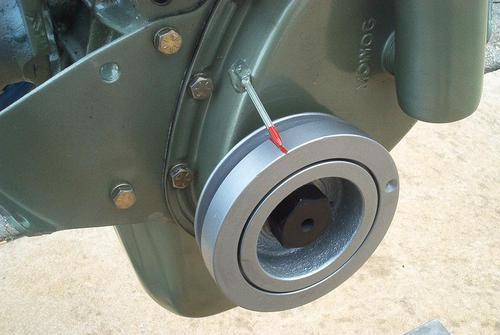

I do it on all the engine I buuild with bottom timing tabs, all I can fiquire is when they design this is was a Guiness morning :smile: Jeff kit is perfect for a engine already in a car, simply bolt on job, if you building a engine and it it on a stand then you can make your own, mine are very simple, yet sturdy, I just mark TDC, because 99% of us are using dial type timing lights now anyways.
Try Jeff for the bolt timing pointer kit
www.advanceddistributors.com
Here's a photo of the ones I make when building a engine.
