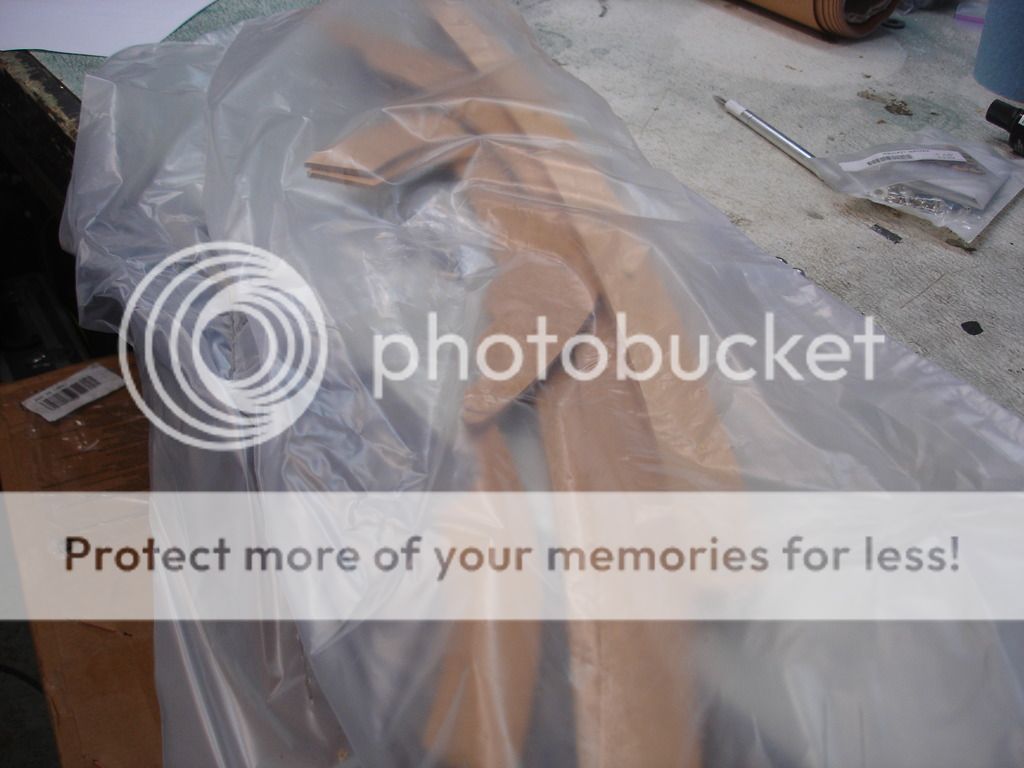

Hard to believe it...but this tiny bag is the entire hood! I had to open this one to make sure, it was so compact. Here I did find an issue with the Skinner kit. My car uses all tenax fasteners. If you have a sharp eye, the hood and tannau were sent with lift-a-dot retainers. I have an email out to see if they will send the correct ones.

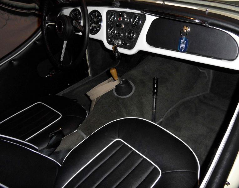

Sorry I don't have any pictures of the process, but here's one of the finished seat. If you look closely you might notice the drivers seat bottom is much lower than the passenger seat. I am 6'1" and my head pushed up the canvas with the top on -with the top off, no hat or sun visor would stay on my head 'whilst motoring'. Rather than reduce my height, I lowered my seat.
The car came to me with only one seat (in terrible shape) and I happened across a set on ebay complete. They were refitted with solid foam instead of springs. I removed the bottom cover, cut the foam in half with a long razor knife, and stapled the cover back on. It's not quite as comfortable as the full foam seat, but anything less than 5 hours is barely an issue. Until you sit in the car or look closely, it's hard to tell, but driving lower makes a huge difference. -Yes I know, the seat bottom bead pattern is for a slightly older TR and not correct for my TR3A, but for a total pair of seats investment of $510, I am very happy.

I have done it a few times with the horse hair and burlap and cotton batting and it came out fine. This time I was waiting for you to start because you have been so talented in other areas, and I was going to copy you. I was hoping you were going with black because you were helping me with my side curtains. But that is only cheap vinyl.
I bought my seat covers from Tim; the quality looks great and totally original. For padding, I am going to with cotton batting and synthetic foam and padding. I was thinking about doing my own door panels because most the car is carpet and I made some carpet patterns last time, and have a door panels to copy.
The spring you bought are different than old school spaghetti springs and make for a higher ride with an odd shape and not an original look. TRF sells the older springs and they are higher in the front and cushier plus feel better.
I am still not starting until you because I think your skill level is higher than mine and you’re being modest and slow playing your hand.
Steve
You scared me, Steve! When you said not original look on the springs I was worried the upper wire was off. I think the upper wire is the correct shape...but I'll study it closer when I get to the seat covering. I was not happy with the non-original spring design, but decided that since it doesn't show I didn't mind that enough to return them to Rimmers. We're short in our family, so maybe sitting higher will be a good thing. If not, it would not be the first time I had to start over from scratch! Of this entire restoration, I have spent more time behind the scenes looking for seat parts than any other facet of the job...by at least a factor of 3 or 4!
John I bought the springs on the black seat from Moss, so they could different than yours. The seat is out of my driver and the springs have gone down over the ears. The white and black are my new ones I am playing around with the foam and an original look. They only have burlap and 2 inches of padding slightly bigger than the spring frame and again the black seat has flattened out with more cotton batting. The padding can make a big difference. The spaghetti springs make for and almost cantilever look for the top section.
Were as the coil springs are flatter and stiffer and that is why the ride is higher. I do not want to cause problems because I might be one of the few that sees it. TR2 and early tr3 seat are heavy fluted and are not seen often, so who knows.
The seats I am doing are spaghetti springs for a 58 tr3a. The only difference I know of is that the early seat had more square corners and no difference in height.
Interesting, Steve, seeing both types next to each other. It appears the lower seat has more padding over the top and sides, giving it a "leaner" look too. I would have preferred the original spaghetti spring set...but after 3-1/2 years a deal never showed up. I reached a point where I had to go with what was available.

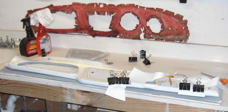

I started my upholstery with the dash. The water temp gage has the long capillary, so it cannot be installed until the dash is covered. In addition, I didn't want to work around the steering wheel, that is another reason the dash was first on the list. So here comes our first panel, the dash!
The kit from Skinner came with a roll of material. Here is the one allotted to the dash...pretty obvious! Notice I have cleared ample area and lay down towels to prevent marring the leather. Oh...I went with Skinner's option of all leather for the interior. I know that is not strictly original...but I have been sewing both leather and vinyl for decades...and I still have to study material closely after installation to tell the difference. I could not resist going with all leather. As far as covering is concerned, both materials are very similar Leather stretches a bit better, bu also mars easier if scratched. But the installation techniques are identical.
A good interior kit will have a sewn pocket for the steering column. Otherwise you will never get the material to turn the rounded corner without slits and puckering.
For the center instrument cluster I found the smallest piece that fit it. We will start here, as the flat panel is easier to get us warmed up for the curves on the main dash.
By pressing the panel down firmly, you will get an imprint to work from on the back of the leather. For vinyl you may want to mark the area covered by the panel. You can also see I am removing the unobtainium brass thumb nuts and setting them aside for now.

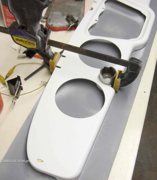

Here I am using the instrument panel to hold the edges down while they fully dry. I will get into the corners shortly...

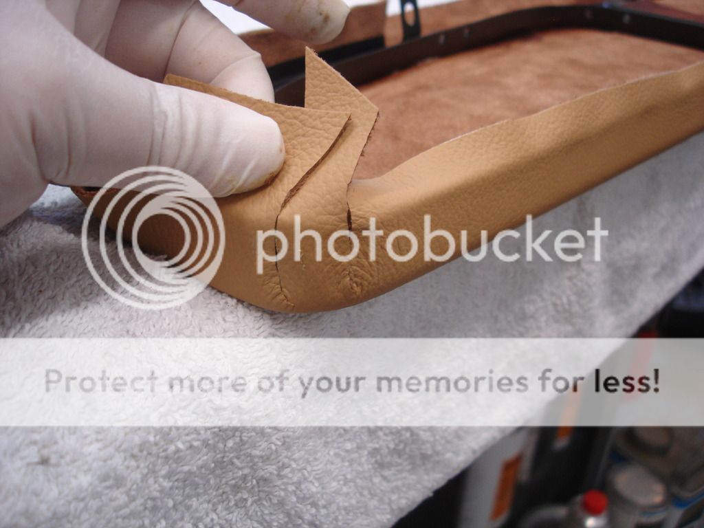

I always do the straight edges first. Oh, I know I said the bone tool is plastic...I was wrong! I looked very closely at it, and sure enough it is real bone. It has been highly polished, but modern bones are still truly bone!
Now the long curves, which need no special work. Now we only have the tight curves. We'll take care of those using the slice technique.
Just like that. Now you just keep working along the curve, slicing only as much as needed, and no deeper than needed. Pulling the material fairly tight decreases the number of slices you have to make.

The bottom gets bunched around the end, like this. You may have to pull off and re-stretch a few times until you get it right.
And...another technique is a heat gun to shrink leather and vinyl. Heat shrinks both materials. Water and ammonia stretches leather. For vinyl, heat will also stretch it!
Trim the selvage and glue it around the back.
