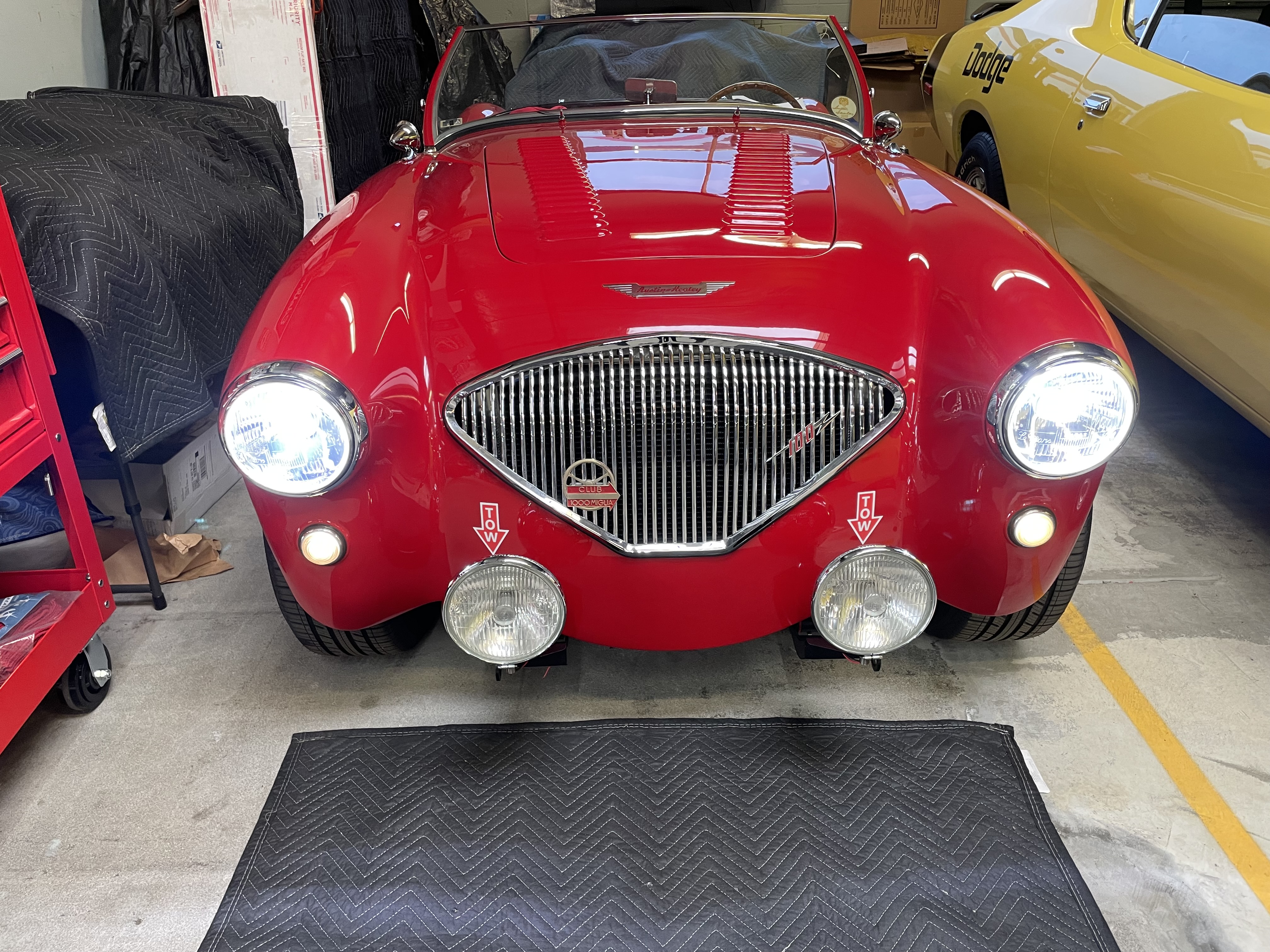

I used this company. Very satisfied and great customer service. My Healey is all LED except for the headlights, but those are going to changed too.

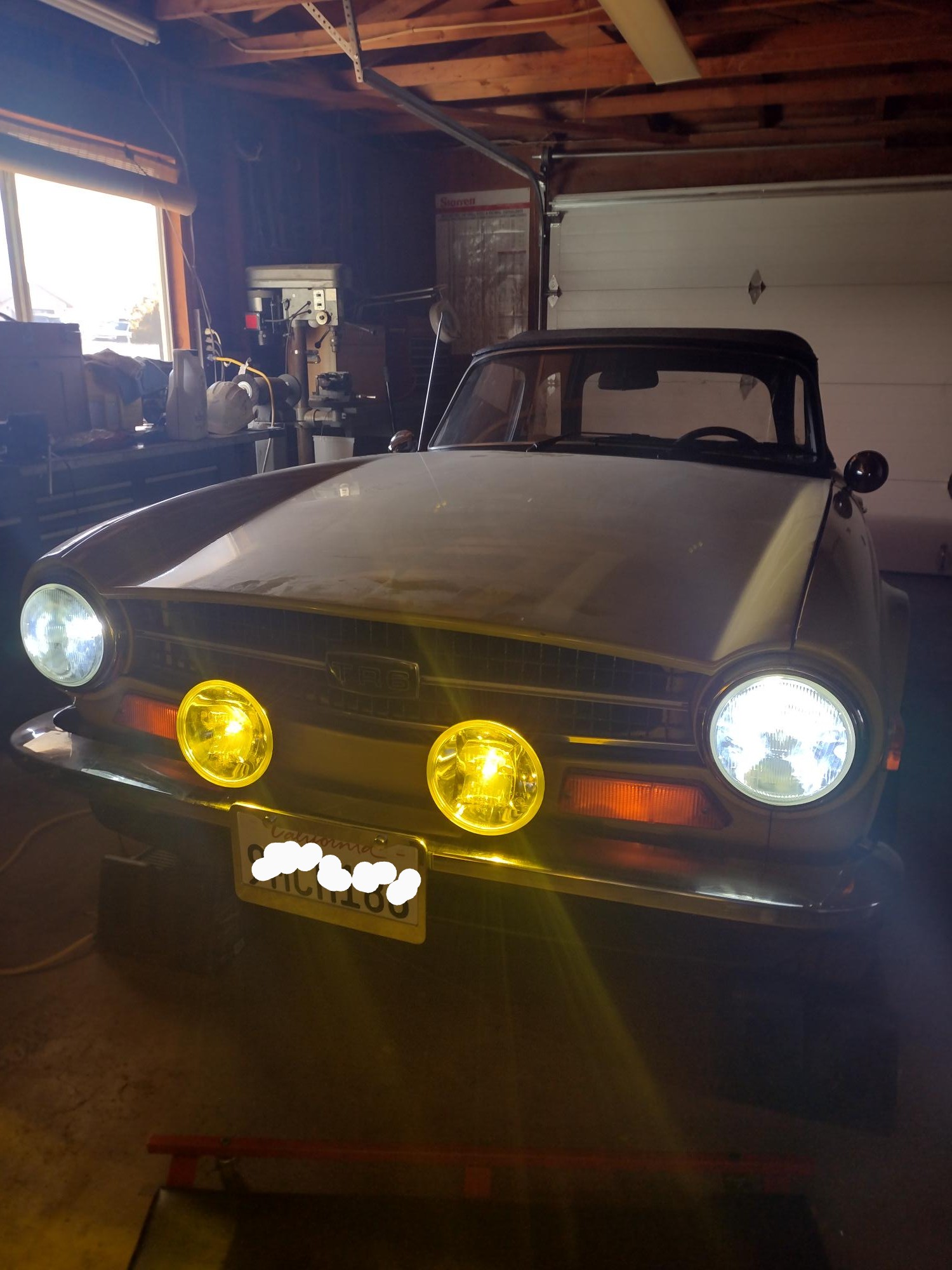

I run LED's in my TR-6 headlights & driving lights. I use some Chinese made bulbs that fit right into the H4 & H2 sockets. the brand name is Auxito. I have used these on my British motorcycles and my Japanese sports car as well. I have never had a problem with any of them, and the fit is great. This setup allows me to have lots of light and still use the stock alternator and wiring. I have put lower amperage fuses in the lighting circuits to protect the 53 yr. old wiring. Originally, Triumph installed 35-amp fuses in everything. Bad idea in my way of thinking. I usually buy these LED's on eBay. ...J.D.

One thing that should be touched on. With LED bulbs, it is imperative the bulb be indexed in the fixture correctly. In LED bulbs the light pattern is shaped by the bulb itself, not the lense. To get the proper flat beam you must make sure it is installed right. On my car, I switched to the European style H-4 headlight fixture, then installed an Auxito LED. That way, I can change bulbs to anything I want at will, without having to change the whole sealed beam assembly. ...J.D.
I like running my TR-6 in the summer, after dark when it is cooler. It helps to have lots of LED lighting. ...J.D.

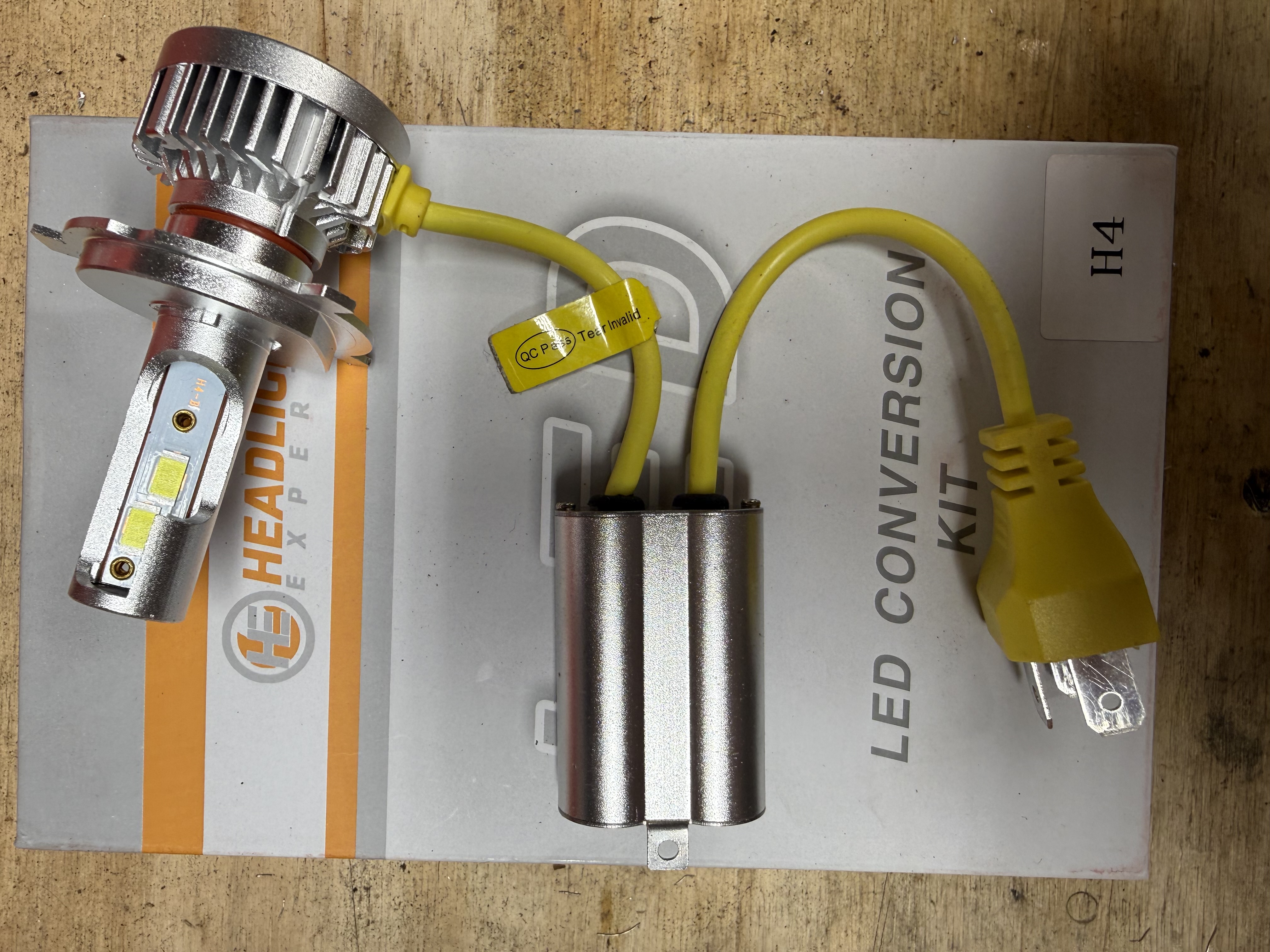

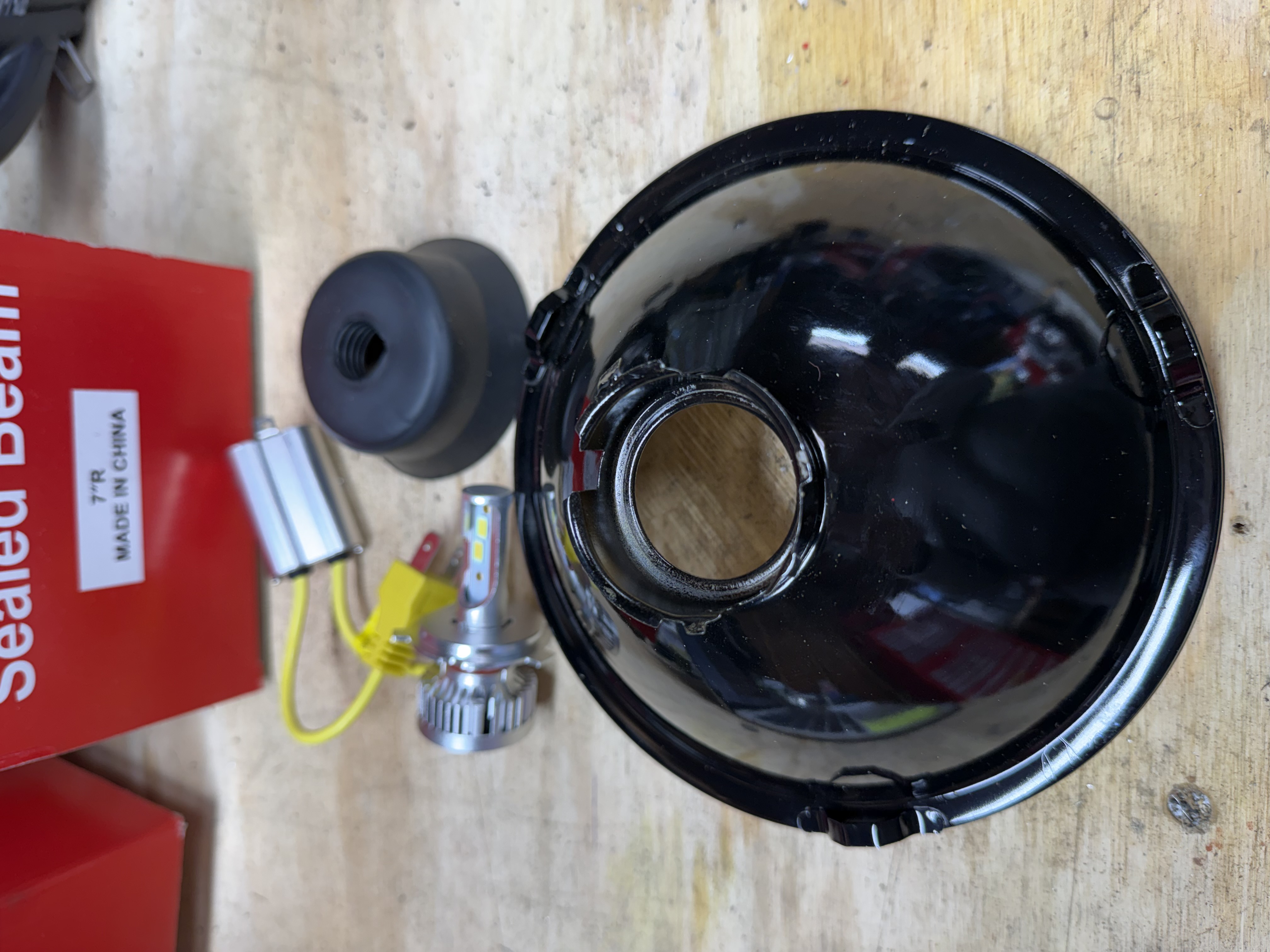

This morning I began installing the LED conversions I bought from Headlight Experts. I removed one of the present Halogen headlights, mounted the LED light in one of the new reflectors/bulb holders and as a test before completing the install I plugged in to the existing receptacle. It lit up with bright white light--wonderful so far!
Since the conversion kit did not come with any instructions nor can I find any on HE's website my questions relate to mounting of the capacitor and whether or not I am to use the rubber boot which goes over the rear of the reflector housing.
There seems to be a small tab on the capacitor with a hole in it which tells me it is to be mounted to something to secure. There is no recess in the bucket into which I can tuck the capacitor--how is it to be mounted so it is not bouncing around inside the bucket?
Also I cannot tell whether or not I am supposed to put the rubber boot which came with the reflector over the rear and if so do I simply cut it to fit, or do I discard it? I have the rubber boot from the present Halogens but it is pretty old and stiff so if I do need to use a boot I will have to cut the new one.
I have an email into HE for support but they apparently do not have any live or online support. It is very easy to order parts from them via live phone but unfortunately they are not set up to make support as convenient.
To perhaps clarify things attached find two pics. The LED bulb fits nicely in the reflector but what am I supposed to do with the loose capacitor?
I'd appreciate hearing from anyone who has ccompleted the installation. Thanks in advance as always.
