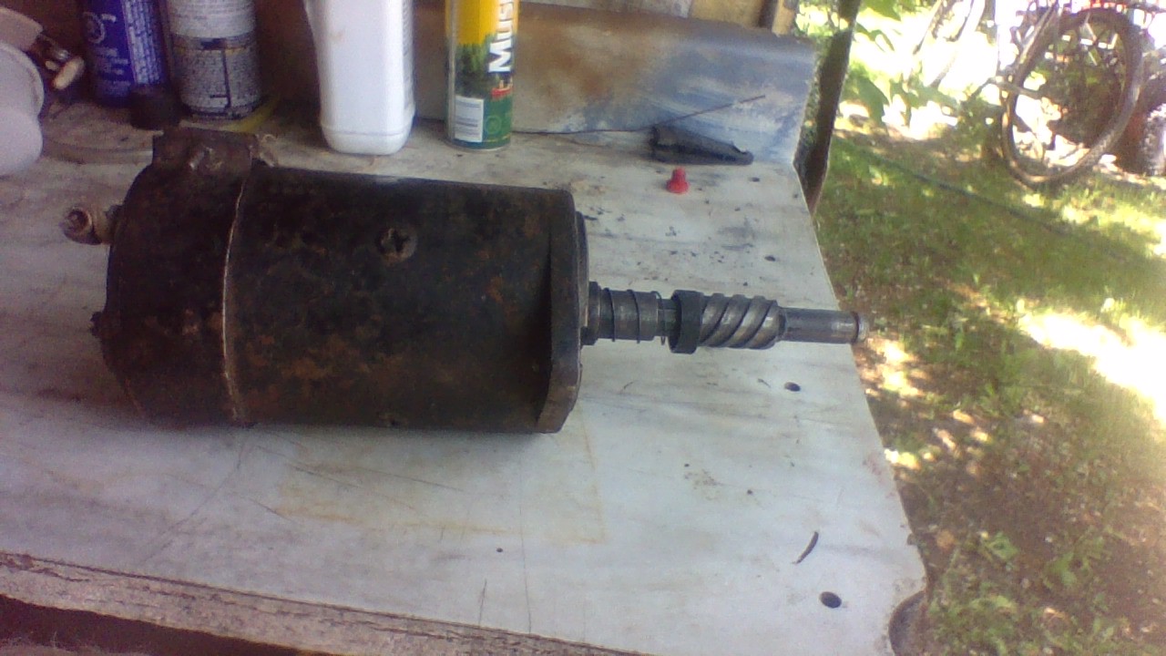

Well I had to remove the header bolts.move the carbs and remove the intake manifold to get just enough clearance to get the sucker out and this is what I found. It seems that a number of pieces have let go and found their way into the bowels of the gearbox. I suppose I will have to remove the gearbox to get at these parts or get creative with some sort of Mgiver magnet tool? Anyway a good excuse to change the clutch that I have been putting off. I guess a Hi Torque starter is in the cards for me as I don't think parts are still available for these old time units? I do have a spare flywheel and ring gear if I need that. It's always something!

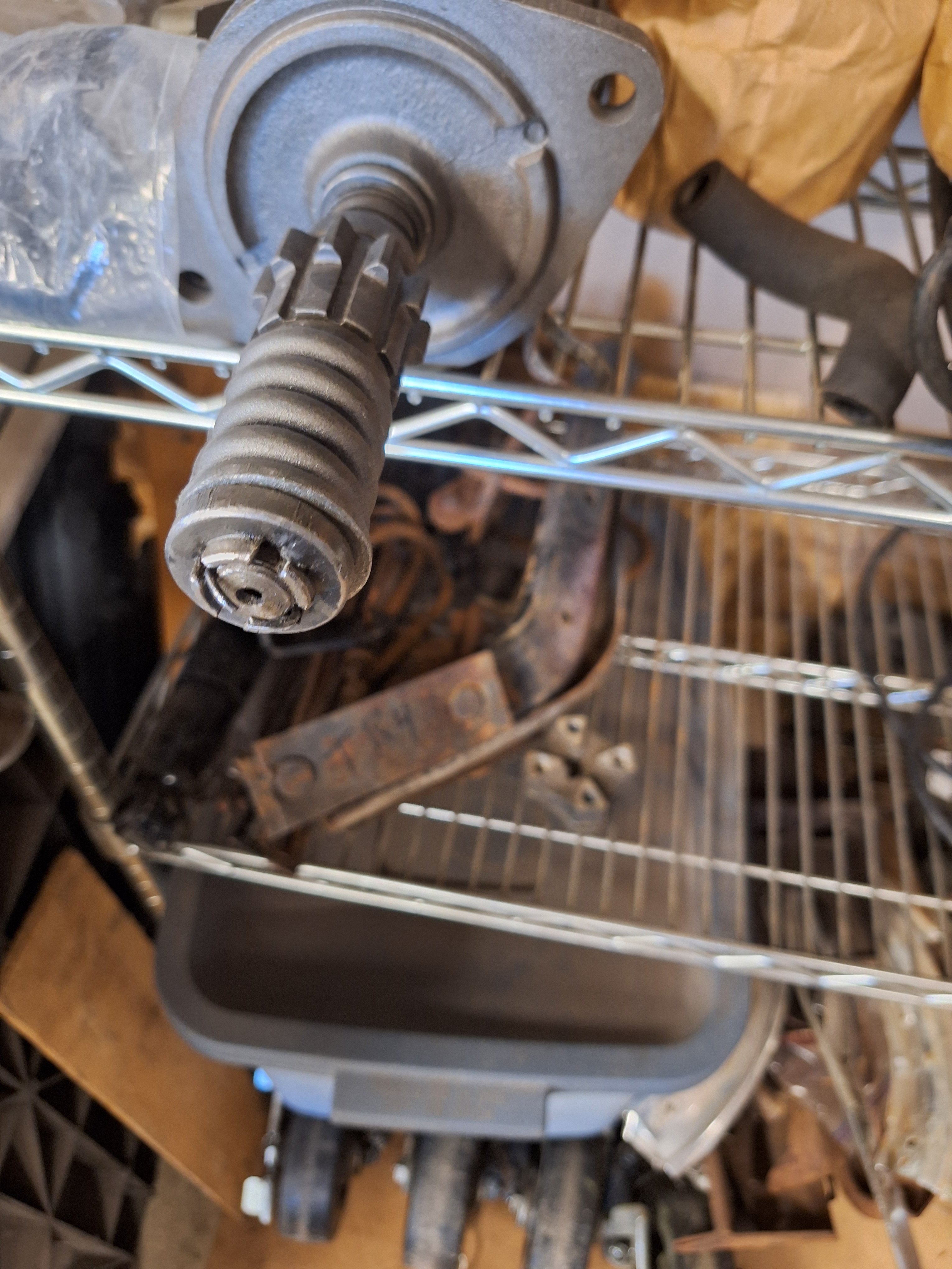

Unless you are wanting to buy a new starter, I suggest you fish out the parts and see what you have that is not damaged.
This could be as simple as the cotter pin coming out, the end piece unscrewing off the shaft and the large spring, a collar and the gear drive hopping off the shaft into the bell housing.

Your right. I'll see what I can salvage. I don't really want to buy a new starter at this point.(y)
