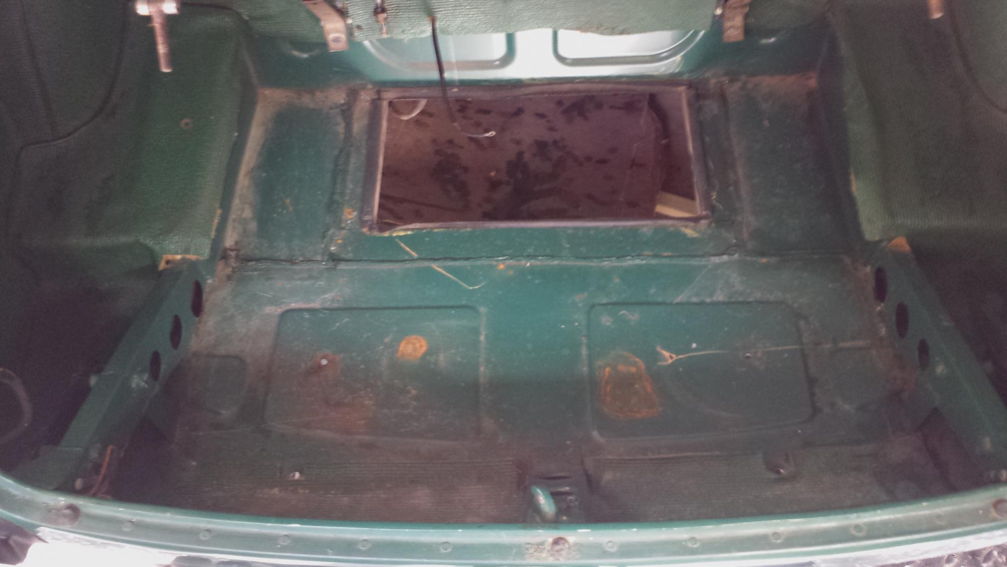

This weekend I spent some time on the fuel system. I pulled the fuel tank out and marveled at the cleanliness of the original sheetmetal and paint:

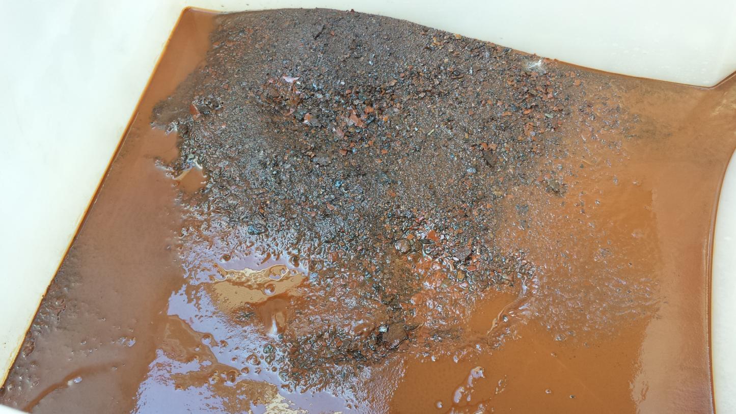

Then I pulled out the fuel tank sending unit and found out why it always reads 3/8 of a tank... float was stuck. I freed it up with some cleaning, and used the large hole in the top of the tank to help flush all of this out:
I flushed the tank with gallons of clean fuel, scraping chunks out of the bottom. Recycled the fuel by straining with paper coffee filter for my lawnmower. I cleaned the gauze filters at the carbs, and put in some fresh fuel. Not sure its as clean as it needs to be, but the tank sure is easy to remove if I still have trouble and its miles cleaner than it was. -- next step will be a boil out/ coating inside at a reputable fuel tank restoration place if crud continues to be an issue.

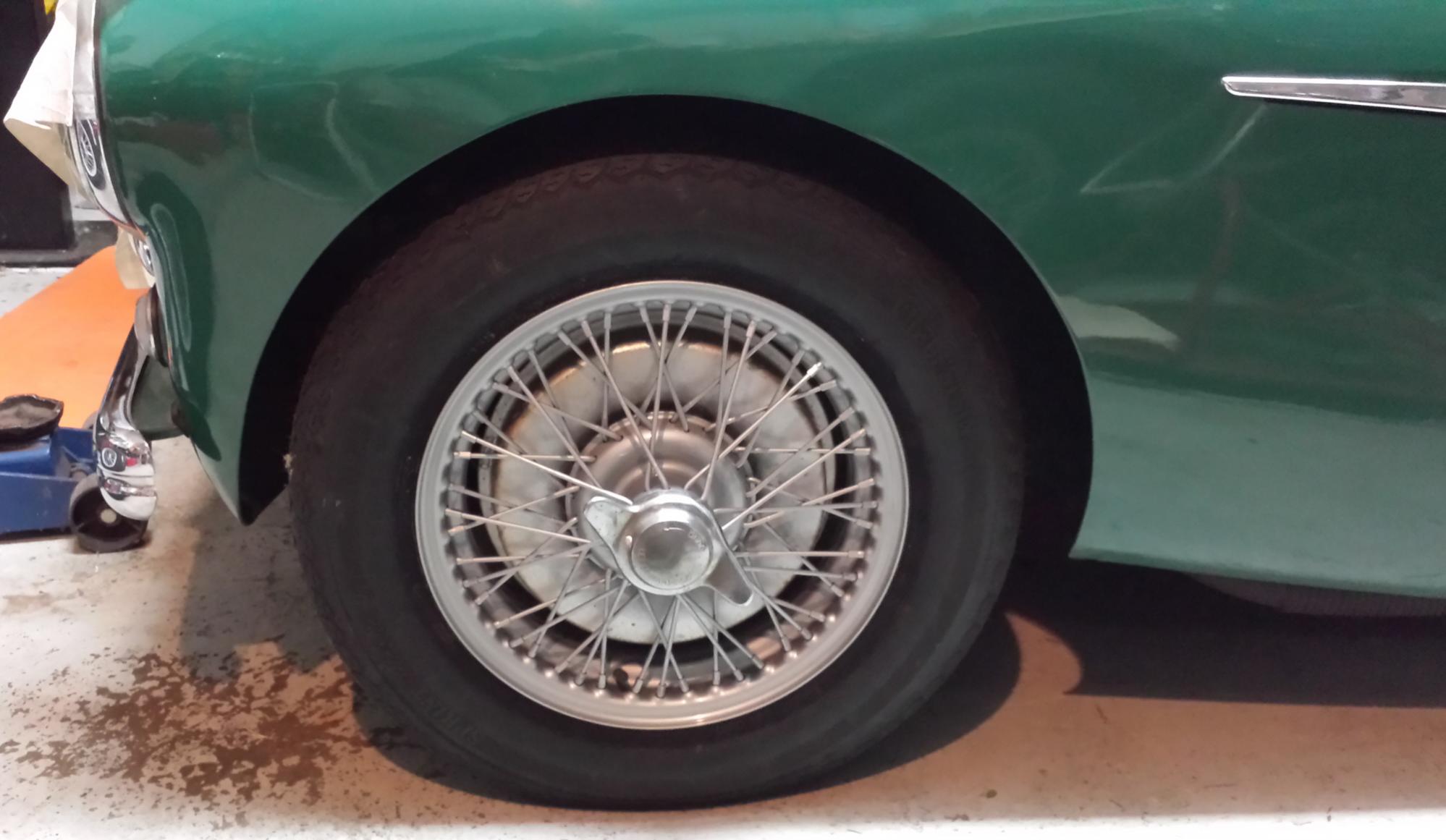

Put brand new Dunlop/ MWS 48 spoke wire wheels and Vredestein tires on last night. They are quite a bit smaller in OD than the original Dunlop Road Speeds, but Moss lists them as a replacement...

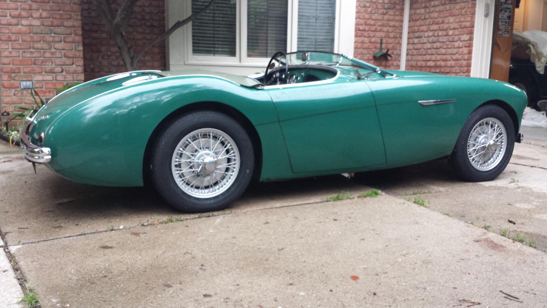

Just drove the car on the new wheels and radial tires -- WOW what a difference. The car is truly a fantastic car to drive now. I decided to try driving with the windshield down since I vowed it would never be put upright again--- but I have to say that even with sunglasses on, any speed over about 25 is unbearable. Too bad there isn't an in-between position that meets some type of compromise. Looks so cool with it down. I love this car.
