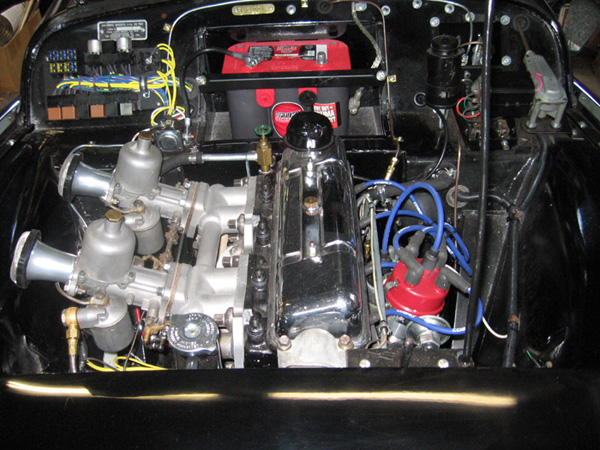

Yeah, what's going on with the "group buy". I'm interested. I have a TR3A, and that needs the offset for the over flow tubes. What kind of price are we looking at here??
Edit: I was going to put back on the original air filters, but I don;t think they are much more effective then what I have one there now. As someone mentioned earlier...it keeps out the leaves and birds... :laugh:
He said 10% off when ordering 4 sets of like filters ("like" 4 offset bases I assume.)
I am running K&N 1-3/4" depth NO offset on my 3A. The overflow tubes are attached with a small piece of plastic tubing and I have no interference issues.

Thanks for the offer to help. I am interested in replacing my stock air filters with either K&N or these. I took off my original front filter today and did notice it is offset--and I assume that is for the rubber drain line.
If I am going to spend money, I sure want the new filters to be a simple bolt on.
Paul
Peter,
I took off my front filter and noticed it is offset to the front of the car to allow room for the rubber drain tube.
If I went with K&N or these, would I have a problem with the drain tube?
