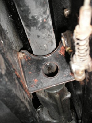

Here's a pic attached of one of the plates installed in the tranny tunnel.

Wow , you went way beyond the call of duty... /ubbthreads/images/graemlins/thumbsup.gif Thanks sooo much for the picture. It IS the part... I just don't remember removing it....
