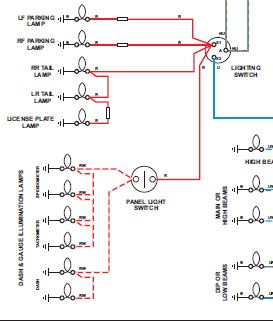

The third unexpected continuity occurs on the panel light switch when the switch is wired according to an otherwise reliable wiring diagram. There is continuity between the two poles of the switch whether the switch if on or off. I tested the switch unwired, to see if it was faulty. It was not; when the wires were removed, there was no continuity in the off position.
I think I might understand why the switch has continuity when it is wired: the red wire from the switch goes to the parking/tail/license plate lamps, which are grounded, and the white-red wire on the other pole of the switch goes to the dash illumination lamps, which also are grounded. So, I assume that the circuit is completing through the grounding connection (essentially, the car sheet metal). Still I remain perplexed: Doesn't this mean that the dash lamps will automatically and always be illuminated, as soon as I turn on the main lighting switch? Which means, essentially, that I could never turn the dash lamps off -- or, said another way, it would seem that the panel light switch is superfluous.
Attached is a snippet of the wiring diagram that illustrates the loom section in question.
Again, I would appreciate any feedback to illuminate the situation.

The reason it works is because normally, the return path to the battery is through the ground connection at each lamp. So any time the main switch is on the tail and marker lights get 12v which flows through the lamps to ground. If the panel switch is off, the panel lights get no power and don't light.
