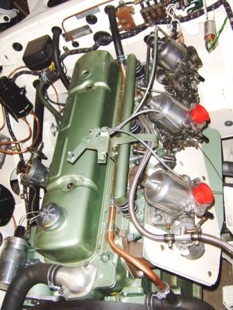

INTERIOR COLOUR IS GOING TO BE BLACK AS HERITAGE CERTIFICATE AND EVENTUALLY IT WILL HAVE A BLACK RAG TOP AS WELL.THE REST OF THE SPEC IS HEATER,NON ADJUSTABLE STEERING AND OVERDRIVE.IT GOT REIMPORTED FROM THE USA IN 1995 WHEN I BOUGHT IT,IT IS RIGHT HAND DRIVE.I PRESUME IT WAS USA SERVICE MANS CAR TAKEN BACK.ALTHOUGH SEVERAL PEOPLE HAVE SAID THAT THE RACING MODS THAT HAD BEEN CARRIED OUT TO THE CAR MIGHT HAVE PROVED THAT IT HAD BEEN TOOK OUT TO THE USA TO BE USED IN RACE SERIES BECAUSE YOU USED RIGHT HAND DRIVE BECAUSE THE BALANCE OF THE CAR WAS CORRECT,AS LEFT HAND DRIVE NEVER HANDLED SO WELL??? DONT KNOW?? WHAT DO YOU THINK???.
REGARDS PAUL

Can't see why a right hand drive would handle any differnt than a left unless you are making all right hand curves which wouldn't be the case in road racing.What kind of racing mods does the car have? Is it a 2 seater or 4? Bill Bolton in Oregon keeps a record of all the tri carbs If you are intrested in registering if you haven't already done so.

ITS A BT7(171 RHD BUILT)THE MODS WERE ADJUSTABLE REAR LEVER ARM SHOCKS,TUBULAR EXHAUST MANIFOLDS,WITH SIDE EXIT EXHAUST,THE SILL HAD BEEN MODED FOR IT AND POSSIBLY THE DOOR BECAUSE THAT HAD BEEN CHANGED(NOT ORIGINAL SET).THE EXHAUST SIDE FLOOR/FOOTWELL/FIREWALL HAD BEEN REPROFILED SO PROFFESIONALLY THAT WHEN I REPLACED THIS PANEL BECAUSE OF CORROSSION I REPRODUCED IT THINKING IT WAS STANDARD.ONLY REALISED IT WAS NOT WHEN I LOOKED AT OTHER TRICARBS.THIS I GUESS WAS TO GIVE CLEARANCE FOR THE EXHAUST.THE MOD WOULD HAVE REQUIRED THE ENGINE TO BE REMOVED.HEAVY DUTY RAD WITH QUICK RELEASE LEVER PRESSURE CAP.EXTRA STEERING COLUMN BRACE FITTED TO OPPOSITE SIDE TO STIFFEN SCUTTLE?.PLUS LOADS OF LITTLE THINGS LIKE BUMBLE BEE HT LEADS ETC.ALL MODS DONE VERY WELL,ALL PERIOD MODS TO, AS I BOUGHT IT IN 1995 IT HAD STOOD APPARENTLY FOR OVER 20YEARS WHICH I CAN BELIEVE,IT WAS VERY ROTTEN INDEED(I FELL THROUGH FLOORS WHEN I STOOD IN IT)REGARDS PAUL
