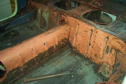

That's what I do as well, dr ice will work on some stuff, but not the rubber/tar based stuff. Here's a photo of 67 MGB GT we're working on right now and doing as described above, it going to a rally car and ran in the LeCarrera Panamerican road race in Mexico, it basicly a hot rod street car with a stripped interior and all the race car safety equipment, roll cage, fuel cell, racing harnesses and seat, etc.. So the idea is to get the tar crap off so it can be primered and have a slick paint job inside , since it will have no carpeting on interior upolstry.
