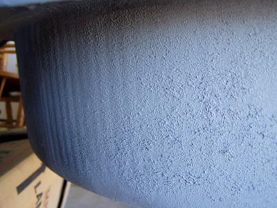

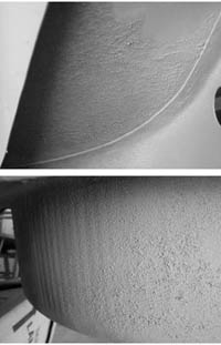

See attached a few images of what I'm calling undercoating. heck maybe I'm just looking at a few generations of road grime that can be pressured washed off.

Hmmm. That almost looks like someone painted over old undercoating, or even over accumulated road grime. A little hard to be sure from the photos, I'm afraid.
All my earlier suggestions were related to the black, tar-like undercoating that you can have appied, or get in spray cans to DIY.
There is also a paint-chip-preventative, commonly used on modern cars that can look somewhat like what's in your pictures. It's a primer that goes on with a pebbly texture, then is top-coated with the final color. This stuff would not have been used on a TR originally, but a previous owner doing a frame-off restoration might have had it put on the underside.
Oh, and the earlier TRs tend to provide some of their own undercoating. Down on the left rear side of the engine you should see a crankcase breather pipe that simply extends down beside the sump. Normally, more than a little oil mist comes out of the breather and nicely "undercoats" the car over time!
You might attack a small area of that mystery undercoat with an Xacto knife or whatever, to see what you've got. Let us know.

Sorry folks, these are the best pics I could come up with. I'm hoping for stubborn road grime but expect the worse.
