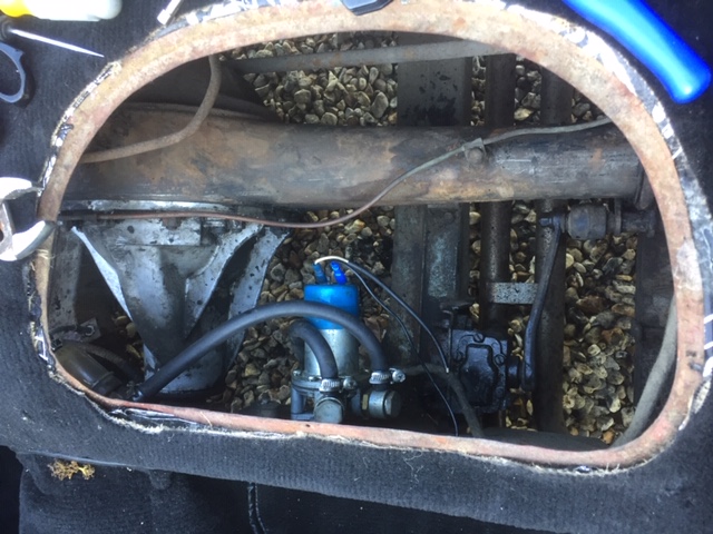

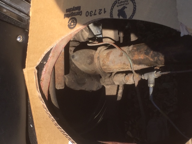

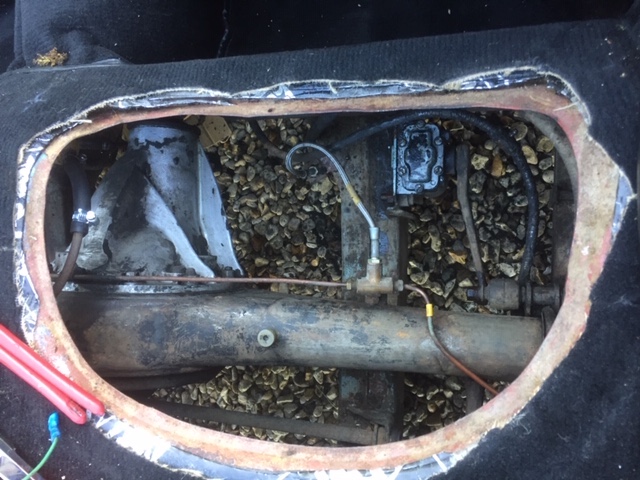

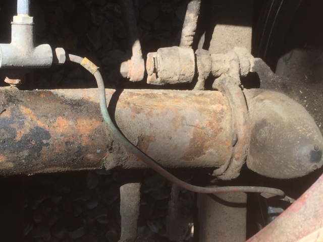

Hi all,
I've owned my 3000 BT7 for nearly 30 years and I've never cleaned the underside of my car. During the current "lock down" I decided to take a look are the rear suspension and started by removing the rear seat pans. What I found was 30 years of dust, mud and oil forming a dense layer about 1/8" thick covering the diff, lever arm shocks, brake plates etc (Photos attached). Even more surprising I found a fuel filter which I had never noticed in 30 years, as it was masked by the bodywork between the seat pans. As it was a Fram fuel filter I assume that is been there for at least 30 years, predating when I bought the car while living in Houston (I repatriated the car back to the UK in 1993). Of course I've changed the filter now(with out success - I'll post something later). I have also opened up the Armstrong Lever Arm rear shocks and was most surprised to find them full of shock oil - again I'll post separately asking for advice on ho to restore and refill. The chassis frame was in fantastic condition showing the original Healey Blue colour over much of what I could uncover.
Once I've finished cleaning I think I'll paint the axle etc (the diff was silver under all that muck), probably look to replace some of the bushes and apply some underbody wax.

Your undercarriage doesn't look all that bad, actually; I've seen much worse. Looks like you have a recently-installed non-SU fuel pump?
