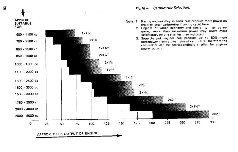

From SU CARBURETTERS TUNING TIPS & TECHNIQUES:
Recently had the engine in my BJ7 rebuilt. Gas flowed head, fast road Kent cam, steel flywheel, Omega pistons, 2 x HD8 carbs, bespoke 6 branch exhaust manifold from Zero, big bore s/s exhaust. Set up on rolling road achieved 172bhp at flywheel. Goes really well, and makes a terrific noise. I have pertronix ignition. I also had the radiator re-cored, and temperature stays at 190C even in the current heatwave
