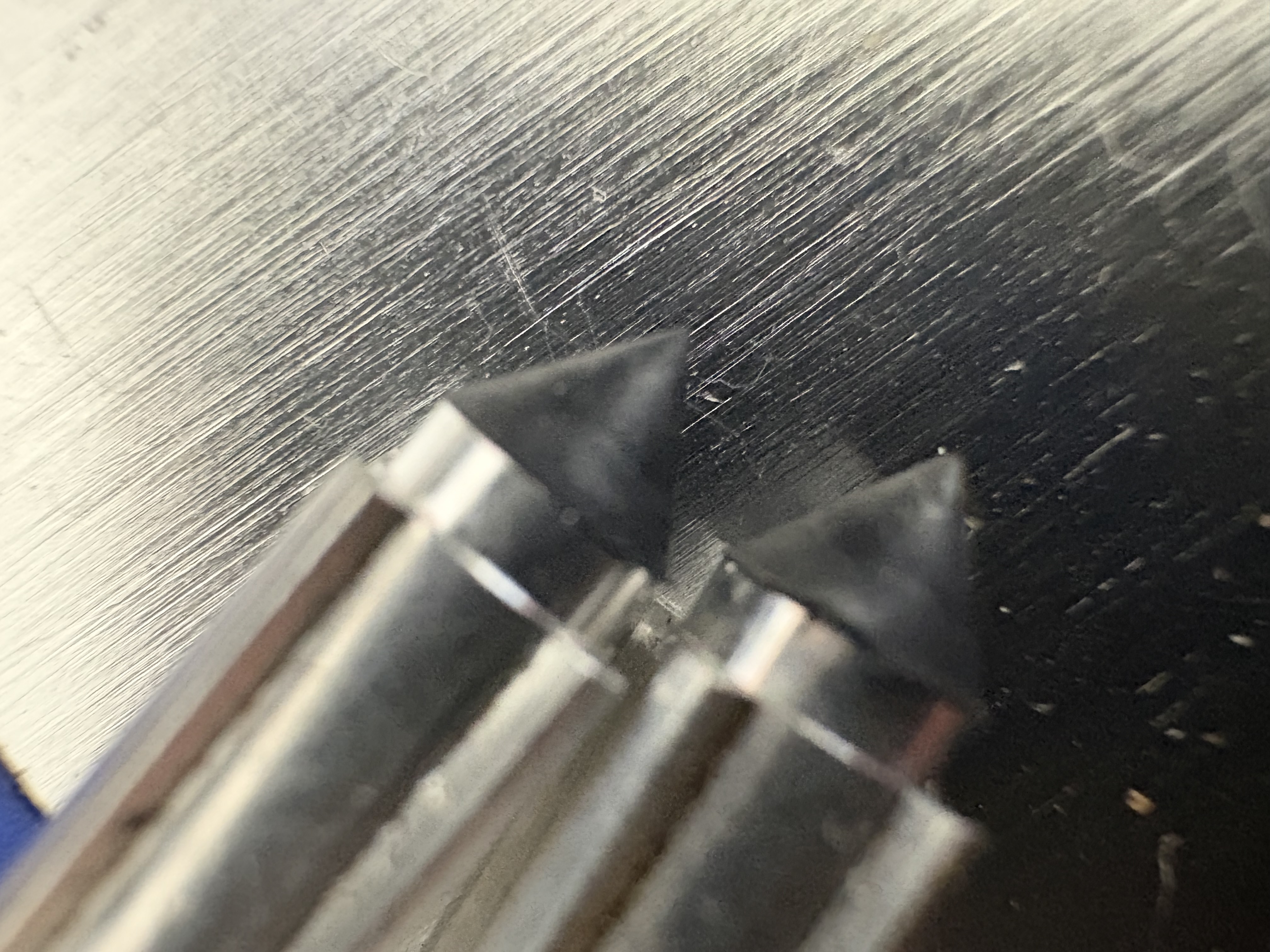

Unfortunately the regulator did not solve the issue. The pressure is well within the range. Engine is running still too rich. I am focusing on the Viton needle, but I am not sure if replacing them again would solve this. Anybody other ideas??
Are both of bowls vented, if not, the floats are pushing against air and never closing the valve.
Thanks for the reply. How do I check this? Do you mean the float bowls? The drains on the cover of the float bowls are open if that is what you refer to.
