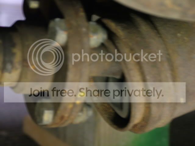

When I was undoing the last part of the rear suspension,1 side only. I forgot to support the rear axle. /bcforum/images/%%GRAEMLIN_URL%%/blush.gif When it thunk to the ground the rear of the drive shaft doesn't look right.I think something broke. Yikes! /bcforum/images/%%GRAEMLIN_URL%%/cryin.gif

Dang,I think the lines are now the worst of my worry!
Not familiar with this cars drive shaft. What broke?

The prop shaft has CV-type joints rather than U-joints. One of the "charming" aspects of the cars' design. /bcforum/images/%%GRAEMLIN_URL%%/jester.gif
Now might be a good time to pick up one of TSI's or Woody's special driveshafts with U-joints. Or have one made up locally.

Was just on the big "2" sites. Put a call into Ted to see what it takes to enlarge the pinion flange holes. Got some other things to talk about too.
Sent Woody the same pic and his response
"From what I can see it looks OK."
HMMMM
Can someone slither under their car and snap a photo of the same thing?
