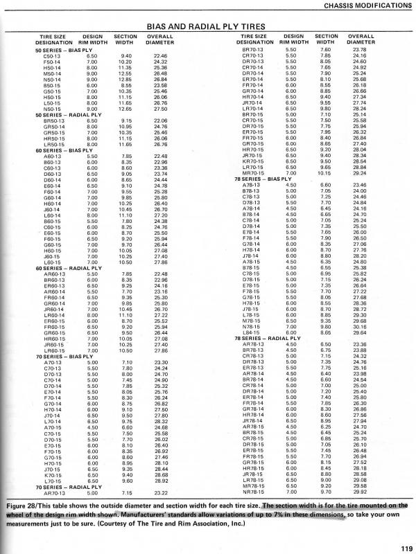

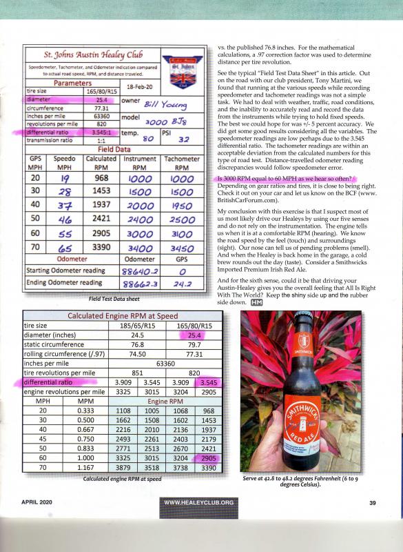

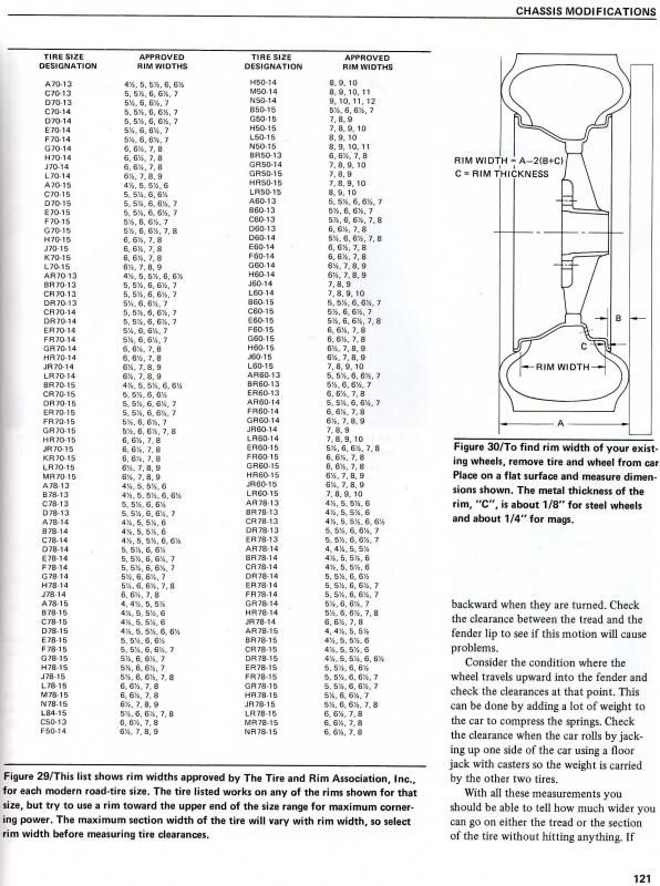

A couple of interesting points relative to this subject. I found it interesting that in Bill Young's chart in the April Healey Marque Magazine about calibrating the tach, he listed tire sizes. In his chart it shows that the 185/65/R15 tire is 24.5" in diameter. And the 165/80/R15 tire is 25.4" in diameter. Almost a full inch difference. Goes to show you really have to read the manufacturer's specifications for each tire you are interested in. Also during my bedtime reading I came across some other interesting info about tire sizes and applications. Unfortunately the charts are dated in that they show very old tire size labeling but in the widths and rim application they are accurate. The one chart shows "Designed Rim Width" the other shows "Approved Rim Widths". A statement at the bottom of the one chart says in regard to rim widths, "Manufacturers standards allow variations of up to 7% of these dimensions". This is from the HP Book "How to Make Your Car Handle" by Fred Puhn.
See charts below:
