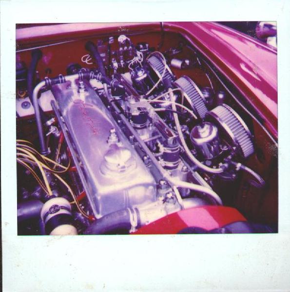

Hi,
I'm running triple 1 1/2" HS Su. +.150 Pistons. Header and full modded head. 12lb flywheel. 1960 trans,.778 overdrive and 3.545 rear end. '58 BN 6.
I get 32mpg imperial and in 4th over I'm doing 70mph at 2700 rpm. Speedo is accurate.
