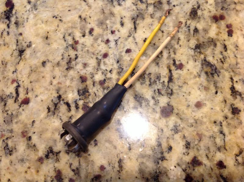

Definitely the turn signal indicator. I hodge-podged a repair over the winter and it came undone. The short blew the fuse. Once I replaced the fuse, almost everything went back to normal, but the flasher fried as well. If someone has a turn signal indicator socket that they want to part with, please PM me:
The faulty indicator:

Rut was kind enough to send me the replacement turn signal indicator socket. The hardest part, of course, is doing the contortionist moves to work under the dash with the steering wheel and seat still in. The new socket spliced right in and fit like it meant to be there. The only hiccup was the replacement flasher that was sent was a three pin unit when it should be a two pin one. No worries, that will get exchanged quickly. I suppose I could manually operate my turn signals with the stalk if I really wanted to take the car out.
