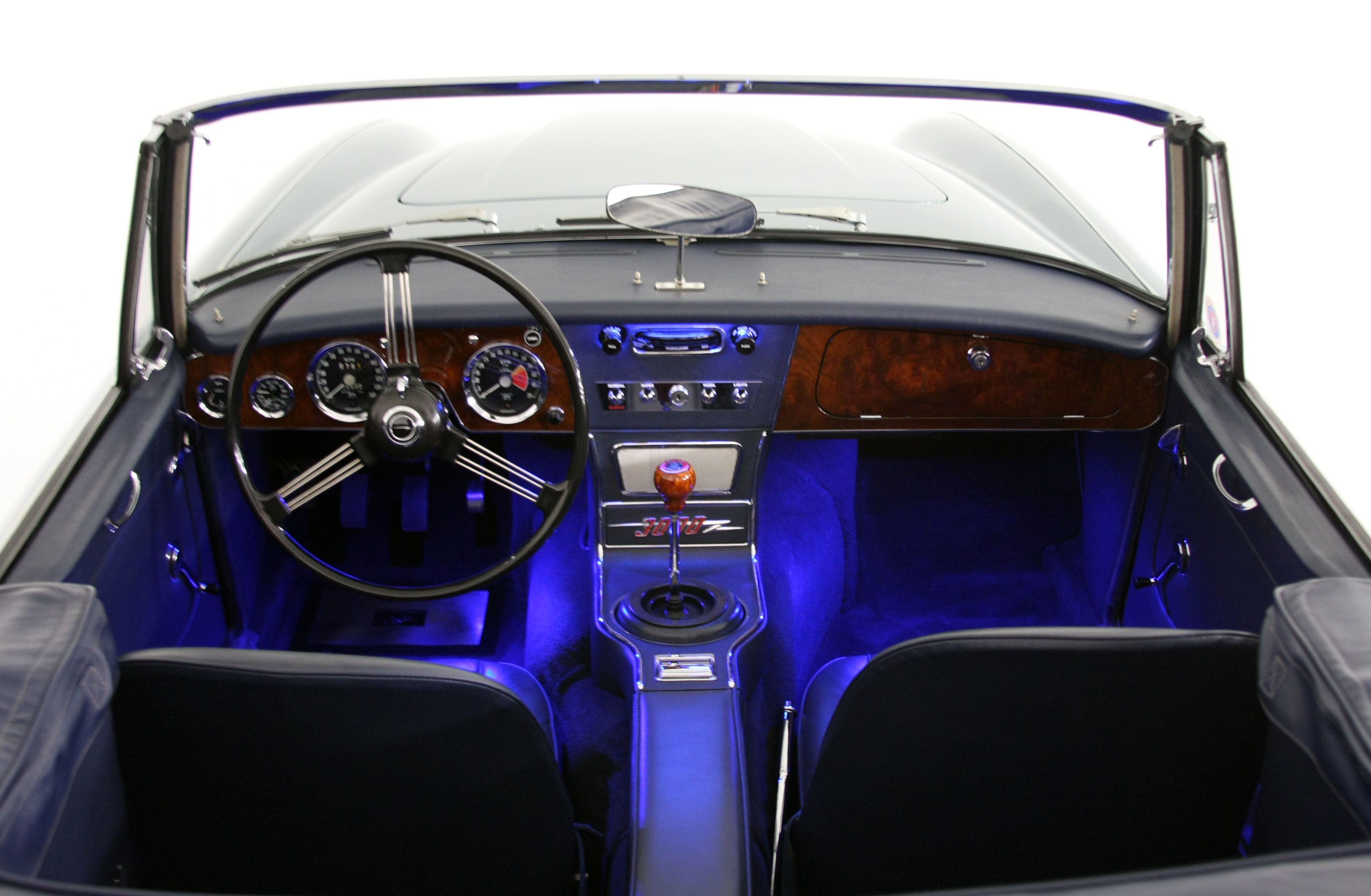

Another option is to connect something like a very bright led self adhesive strip under the edge of the dash panel (or where ever you choose) and splice it into the turn signal bulbs wires. I try to hide what ever I install in the car to keep it looking stock.
Example: I have blue courtesy lights in my BJ8. I put an led strip under the center of the dash and in each foot well. Here's what a led strip would look like under the center of the dash if you go that route. Or maybe on the drivers side windshield post or bottom edge of the frame in front of you.
Here's an example of a white LED strip connected to a flasher.
