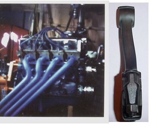

If you want "real" horsepower, a turbo is the way to go. Here is a brief description of a Ford 2.3L turbo engine I built.
It put out about 370 hp at 6000 rpm & 425 ft lb of torque at 4000 rpm. An Air Research T3 turbo was used. It takes a pretty strong engine to use this much boost & everything gets kind of complicated in the control systems but it sure works.
I used forged Venolia dish top pistons for strength & to lower the compression ratio to 8:1.
It was fully ported & a 268 degree cam with 112 degree lobe centers was used. Headers with 30" primary lengths were plumbed into the turbo. Boost was limited to 20 psig with a dash controlled adjustable regulator. BTW, headers help just as much on a turbo engine.
To control detonation on 92 octane fuel, a water/alcohol injection system was set to turn on at 10 psi & up boost pressures. The water injection lowered charge air temperatures by a measured 110 degree F. This is comparable to a 55% efficient air to air intercooler.
An MSD ignition with boost retard was set at 1 degree retard per psi of boost. The block was grooved for steel O rings around the bores to reinforce the head gasket.
To get the turbo spooling up quickly, a 65 HP N2O system was triggered at full throttle, & was switch selected to cutoff at 10 psi boost or could be left on for full power. The spoolup was very quick with the Nitrous. Very little lag.
I foolishly full throttled the N2O at 2,000 rpm in third gear & was rewarded with four Z shaped connecting rods. They were fully prepped stock rods. See attached pic. This is where the Crower forged I beam rods were installed. The problem is that N2O is a constant horsepower affair. 65 hp at 5,000 rpm only adds about 53 ft/lb of torque. However 65 HP at 2,000 rpm adds 170 ft/lb of torque. Thus the bent rods. First & only engine I've had that could blow out the bottom end by just flooring the pedal. I felt that since the rods bent front to back, H beam rods would be stiffer than the Carillo pattern rods which are quite narrow front to back.
A McLeod dual disc clutch was needed to hold the torque. Lot of fun, lot of dollars, I wouldn't do it again.
