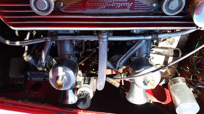

I found a nice set of Jaguar 3" velocity tubes with built-in screens at XK Unlimited and mounted them up in place of the Cold Air Box. I also mounted a small drainable catch can to collect blowby vapor which used to be recirculated back into the CAB.
I don't know if this setup will really give the reputed couple more horsepower but they do allow much better access to the left side of the engine compartment. Plus they look great and produce a nice sucking sound when I get on the throttle.
