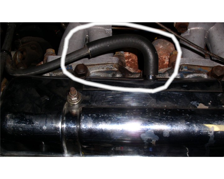

Hi everyone - still working through where the new TR4A stands. My valve cover looks a bit different than the Bentley manual and I can't find a diagram that shows what is supposed to actually be here.
Looks like some sort of breather tube, but on my car it isn't connected to anything. The tube just extends towards the front fender and remains open ended.
I've attached a picture and circled the tube. It is located in the center of the valve cover.
What do you all think?

I guess I would call that the P.V.C. system fresh air make-up hose. Intake manifold vacuum sucks air through the PCV out of the crankcase and into the intake air\fuel flow. The hose from the air cleaners to the valve cover allows clean air to replace the air sucked out of the crankcase. Clear as mud??
[ QUOTE ]
Is there any harm in the way it is currently hacked?
[/ QUOTE ]No, except possibly a bit of harm to the environment. OTOH, if your motor's putting enough oily smoke through that hose, there are those folks who consider that to be rustproofing if the hose is properly aimed. /ubbthreads/images/graemlins/grin.gif
If you are pushing a lot of oily smoke through that hose, you have a serious blow-by problem. Hope thats not the case.
Aim the hose at Michigan, and save all those American muscle cars from rusting!!! /ubbthreads/images/graemlins/wink.gif
No oily smoke at this point - but once I'm done tuning it I'm sure there will be - LOL.
