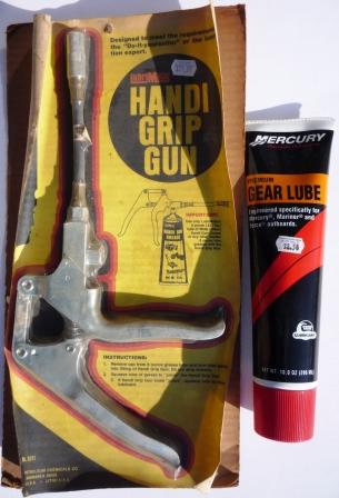

I pickedup an oiler pump at a marine store...
The end fits the grease nipple but pumps gear oil into the trunnion

Steve- You're right about the condition of the one I bought... it looks like Noah had it on the Ark :jester:
Even though the packaging is messed up, it worked just fine. I bought it at a marine store on RT. 222 in Akron. Let me know if you need more info.

I wound up never actually using it, Art. The TR3 takes grease in the trunnions (only the later one-piece trunnion design is supposed to take oil, the early ones leak) and I sold the Sports 6 before ever reaching that point. (Stags have MacPherson struts, so no trunnions at all.)
But at the time, Mercury's P/N 802851 gear oil seemed most appropriate to me. I found a place where it was rated GL4 (although I can't find it now), plus it is supposed to have better "wet" performance and be fully safe for copper/yellow metal.
https://www.mercurypartsexpress.com/us/high-performance-gear-lube-237-ml-8-fl-oz-p188732.html
(Some outboard motors with electric shift have copper windings that are exposed to the final drive gear oil, so "yellow metal safe" is very important to them.)
