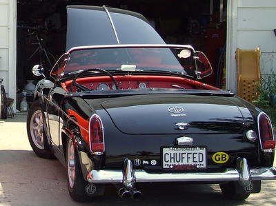

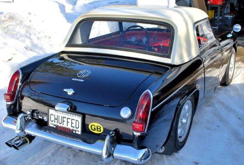

In these pics of my car, you can see the lower (rear) buffers below the boot lid if you look closely.
EDIT: I guess in the second picture they didn't show up so well, but the first one shows them.

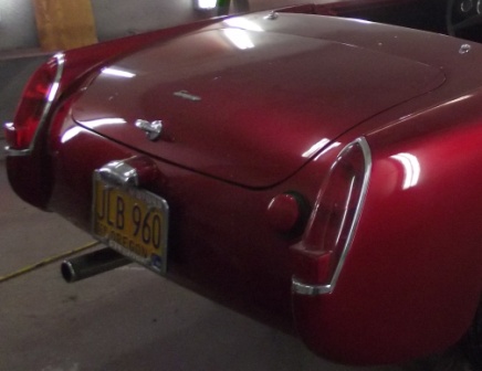

Mine is early, I think 793 or so. This is how it looks. The sealis pretty tight.

If your car is #793, is wouldn't have had the buffers, and probably still has the lighter boot hinges too. Your car is correct without the buffers. It should have the early "L" shaped boot handle too instead of the "T" handle. I can't really tell from the picture.
Very pretty too, I must say.... :driving: :bow:
Looking back at the before pictures we took there are no holes unless they are under the old seal, just a mouse dropping or two :eeek:
It has the "T" handle. May have been changed at some point but that would have been over thirty years ago.
Thanks! That picture is just after they put it back together and still in the paint room. Can't wait to see it in the sunshine all cleaned up!
Still beautiful, no matter what letter handle it has.. I like that smooth clean,,, uh,,,, red - ... uh,,,, rear end....... :angel:
BTW, The "L" handles were known for breaking, hence the change.. possibly why yours was.
It very well could have been. Whoever owned the car before us took libertys with what he cut holes in and how he "repaired" stuff. Multi colored striped indoor outdoor carpet and handtowels on the door panels...
