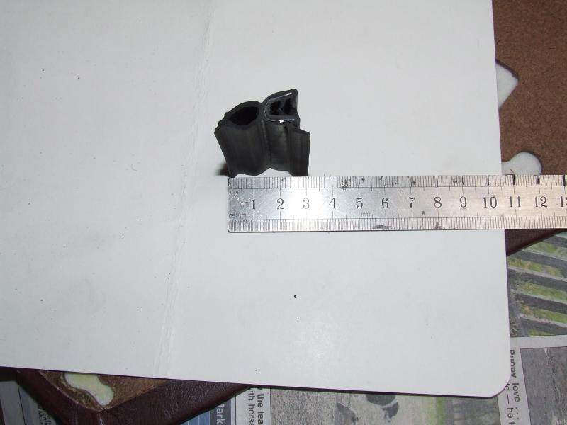

I believe this the correct seal...please confirm or otherwise.
Has anyone used an alternative seal,[ reason being that it is a little too thick around the main bend of the trunk lid and stops the lid from closing correctly].... if so, please describe.

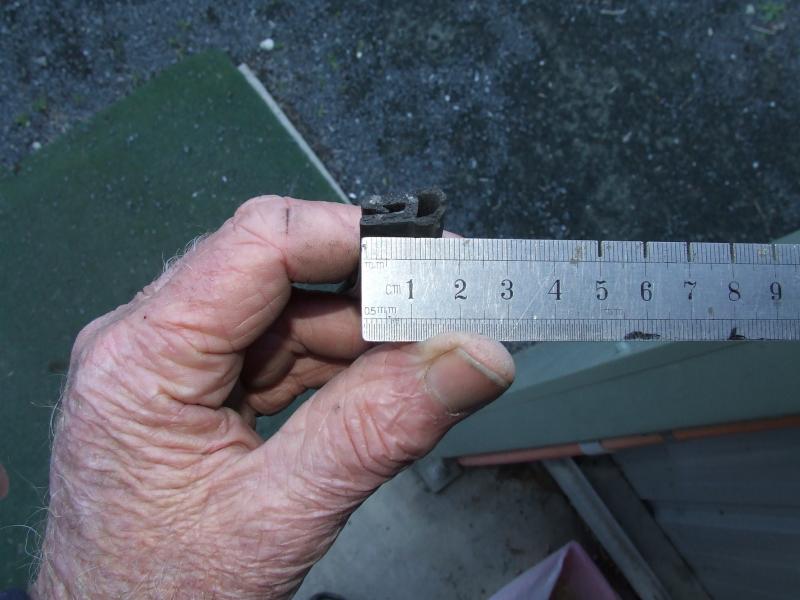

Thanks guys.
I have found an alternative that is a smaller profile and fits well and the trunk lid closes correctly.
Also has the advantage of being steel reinforced so as to clip onto the steel trunk lip....no adhesive necessary....see pics.
Hope that the trunk is completely waterproof.

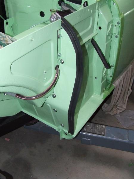

Found a good use for the boot seal pinchweld...now on splash shield.
