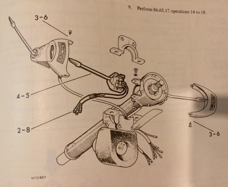

Hope this diagram helps.
FLB... looks like I may be incorrect....
The diagram shows the wires from overdrive switch and light switch going through the trough.
I still think the turn signal wires also go through the same path.
I will have to go have a look at my car to find the turn signal wire routing. Sorry for any confusion.
OK, I just found this "Refitting" instruction. The wires from the turn signal switch do indeed go through the wire trough and then through the steering column clamp.
