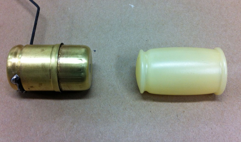

I can also confirm that that brass float works well in a TR8 sender. The diameter of the stock plastic float is about 1 inch, the brass float is about 1-1/4". I also put on a bit of solder to make double-sure, and plan to coat it with the extra tank sealer.

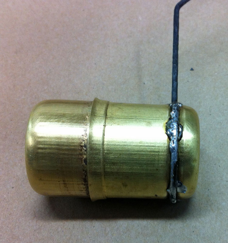

BTW, here is what I did. I cleaned the wire on the sender as best I could, it was hard because it was quite pitted. Then using lots of flux, I tinned the wire. Then I snapped it around the float, applied more flux, and wrapped the rest of the float in a wet rag to keep from heating it up too much. Probably not needed, but just to be safe. Then I applied the iron to the wire, making sure that got hot first. Not the most beautiful solder job, but it should do the trick.

Darrell- Thanks for posting the pics they are very helpful.
And since no-one sees it, you did do a beautiful soldering job!
