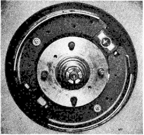

I just had my rear split axles rebuilt and im having an issue. I can not find which way my backplates are supposed to go on. I have the girling 9" backplates and all the pictures seem to be different. Does anyone have a picture of before they put the drum back on. I think that the cylinder is on top with the emergency brake lever towards the rear? Right?

The cylinders go at the bottom and one notch to the rear, so about 7 o'clock position if you are looking at the right side of the car, or 5 o'clock looking at the left. The handbrake lever points up in both cases, so it lines up with the compensator on the axle. Here's a shot of the right side from the workshop manual.
