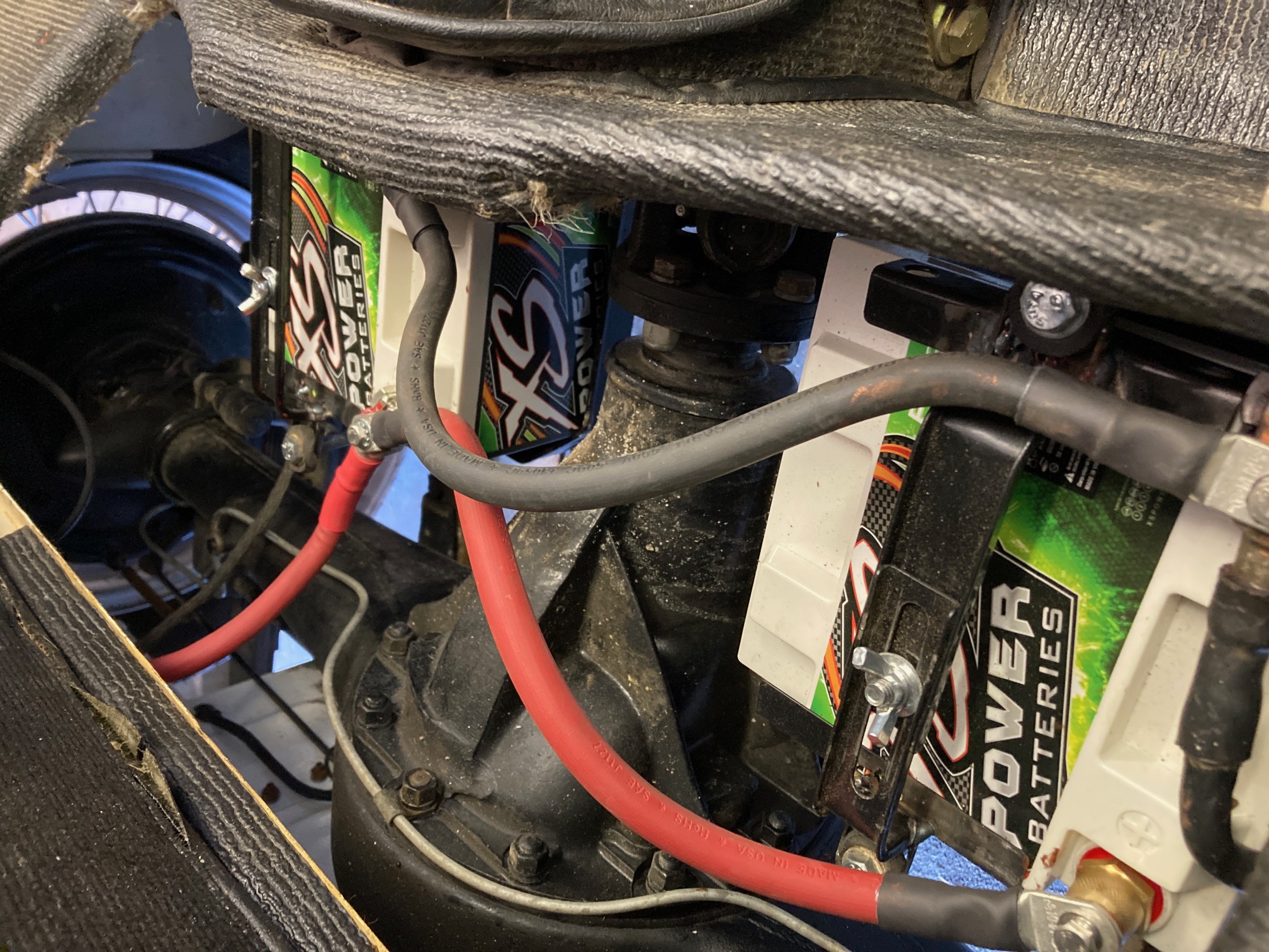

I gave up on the dual 6V setup after years of trying to make it work, so I fabbed my own rig. A couple 'off-the-shelf' brackets and a little bit of cutting and welding--I needed the practice anyway--did the trick. A bit of overkill, I suppose, but with an original starter and high compression 950 CCA is da bomb (note 'double ought' cables; WAY overkill ;)).

With that many CCA's the world must momentarily wobble on its axis when you push the start button!
I am waiting for the arrival of the mounting plate from Optima Trays (optimatrays.com/products/75-25-slip-clamp-tray) before installing the new 75/25 battery and will then measure the present and order new battery and starter cables with ring terminals from one of the online suppliers. Since I have no big subwoofers in the boot and run only a pair of Lucas 576 driving lights I figure that #2. or at most 1/0 AWG cable should be sufficient. No offense meant....

No wobble, but I do create a small wormhole. Funny, the old un-geared starter doesn't crank any faster, but it cranks for a long time (of course, the battery will only supply what the starter can sink).
