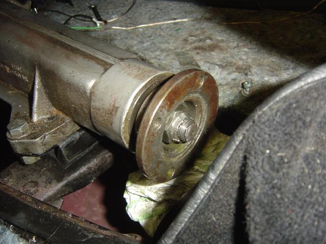

OK I am about ready to pull the engine for the rebuild but on a side topic, my trany has been leaking quite a bit and I figured its the rear seal, got a new one, when I unbolted the drive shaft a lot of oil poured out from inside the rear flange like where the nut is bolted to the shaft, I dont see any other seals, am I opening up another can of worms and will a rear seal solve the leaking?

Hondo,
The only seal back there is the pinion seal. I had oil come out of my original drive shaft when the OD was installed many moons ago.
Undoubtedly, this was another Triumph engineering exclusive to protect the drive shafts from rusting out.
well when I say leak its like pouring out so what the protocal for stopping the leak? use a rubber washer ahead of the steel washer or RTV in the locking nut and flange
hondo
When I repaired the leak in my diff, I took the flange into a machine shop and had the flange polished so that the seal would mate better... got rid of any groove from all those years.
I only bring this up so that you at least inspect the tail flange to see if it might have a grove and need to be polished, etc.

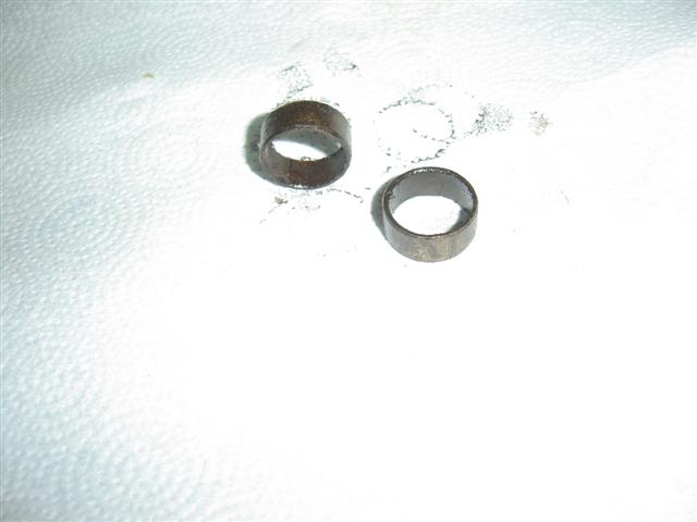

got the tranny out, the clutch fork pin was not broken but check out the bushings, it appears the wrench monkey cut one busing in half to make 2. they appeat to be 3/8 inch wide some people need not work on anything... Idiots

Actually, the bushing means that someone followed recommendations and installed 2
:iagree:
Only better arrangement (IMO) is to use the bronze bushing from the earlier TRs (which is about 7/8" wide) and add a grease zerk so it can be lubed.
On the oil issue, it sounds to me like that big nut was not tight, and so oil was leaking through the center of the flange. If the seal is leaking, the oil gets thrown out in front of the flange.
Torquing the nut to spec, plus maybe a little Hylomar or RTV on the big flat washer should solve it.
As noted above, make sure the sealing surface is perfectly smooth. Install a Speedi-sleeve if necessary. Also check the housing bore where the seal fits, for nicks or burrs. Be sure to lubricate both seal and surface generously, so they don't start up dry.
