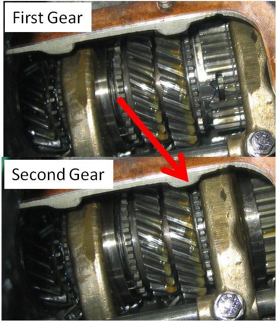

Regarding 2nd gear: a pic of the assembly in 1st gear ( no issues) and 2nd gear through a mirror ( I can't believe these pic's came out as well as they did)! First gear, no issues. 2nd just doesn't slide far enough for the fork to engage the gear. Fork retaining screws are engaged with the shift rods. I've rolled the transmission around with the clutch disengaged while holding pressure on the shift rod toward 2nd - never have gotten into second. Help!
Ted,
The 1st/2nd gear synchronizer hub has 3 springs and balls that are fitted between the inner and outer hub. It happens sometimes happen that the outer hub can travel too far forward and allow the balls and springs to escape. The spring can protrude get jammed, bent or sheared off, preventing travel into 2nd. If you can fish around the bottom with a magnetic wand fo one of the balls, this might confirm my suspicion. This situation will often lock the car in gear, but it depends on how bad the two hubs are jammed together.

Thanks for the link - just what I needed. There is only one ball and spring, the other two are missing. The shift rods and forks appear to be new. The more I look it appears someone did a poor re-man. I'd better do a complete tear-down.
Hey Gerard - next to the Figure F-5 you referenced there is a note about installing the 1-2 gear assembly. That if it's installed incorrectly => no second gear! That was it! Someone had this trans apart and mis-assemblied her. Thank you so much for the reference. Now I'm shopping for parts.
