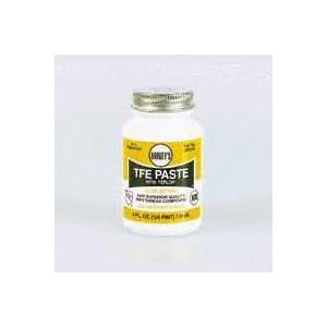

:iagree:
The threads are tapered, and are where it is supposed to seal, so the plug should not fit flush against the case. Better to use the paste form than the more common tape, so it can't break off into strings inside the case.
If it still weeps, then likely the threads are damaged (or that plug is the wrong thread). There are stronger sealants available (Eg, Loctite 565 ) but they shouldn't be necessary.
