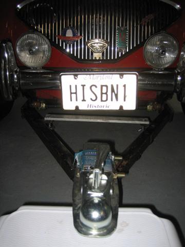

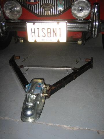

Here's a picture of the collapsible (folding) tow bar that I use in conjunction with a pair of Bill Bolton's tow eyes. Works like a charm.
Here's a shot of it hooked up to the car.
