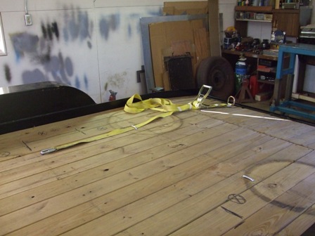

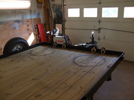

Now back to the subject at hand. I have spent the last few days attaching a variety of hold down points on my new trailer. I did not buy the e-tracks because I think for the expense and work of installing them they are only good to one car or some cars that would have similar wheel tracks. Probably a lot of the LBCs might work with one set of E-track but I doubt if a Vette would ride in the same place as a Healey. I won't be able to load the Healey to test my system till next week but here is what I plan. I'll attach a pic. The front of the Healey will be strapped from the lower 'A' arms to new 'D' rings at the front of the trailer. Then at back edge of the trailer I have welded on new 'D' rings as well. But in between the distance from the back axle of the Healey to the rear D rings I have installed a 2" wide squared 'U' bolt that is bolted thru the wood deck and also thru an angle iron cross brace under the trailer. This squared 'U' bolt has nuts and washers on the underside but the nuts are not tightened all the way up which allows the U bolt to raise up enough to feed the strap thru it and also to allow the strap to run freely thru it. When at times, maybe when trailering other cars, the U bolt may not be used it will drop down nearly flush with the deck. I will run straps from the rear D rings, thru the floating U bolts and then I will wrap the straps around the leaf spring just forward of the spring plate holding the spring to the axle. I can then pull the car tight by ratching the straps at the rear of the trailer. My reasoning for the intermediate U bolts which are about 12 inches behind the location of the rear tire is to provide a more veritical pull downward near the axle instead of a longer pull which would be more horizontal without the U bolts. I fear that a long horizontal pull to the back edge of the trailer might have the straps foul against the back edge of the rear shroud or against the exhaust pipes on the drivers side. I'm open for criticism, let me know if you think this will work. see the attached pic.

Blueskies, since this is my thread I guess I can hi-jack it just a little. Yeh, I wouldn't use a Vette moniker on a Healey web site except way back when we (or at least me) started using this new fangled "Inter Web" i being a Corvette guy decided to use Vette for everything. It was even my e-mail address. Now after all these years if I change it I will lose a lot of history from previous post. So i guess it just stays.
What you have will probably work, however I would be concerned about the rating of the straps. Keep in mind that if you have the misfortune to have a collision that the load on those straps could be up to 30G's or so which translates, on a 2,000 lb car to a 60,000 lb load on the straps. Now I am not saying that you need straps rated to 60,000 lbs as you will most likely never need quite that much, but I would get the heaviest rated straps I could find.
Now ideally the Tire cap/strap idea is absolutely the best and is what professionals and race teams will use to transport cars as all you are doing is strapping the tire & wheel to the trailer and each strap (assuming you use four) is only needed to handle 1/4th of the load and the load will be distributed much more evenly in a collision. The problem is that you need to use the same trailer all the time and permanently fit the strap points to the trailer frame in some way (bolting them to the wood bed will not be strong enough) which means that this will not help if you use the trailer for more than one car unless it is exactly the same size track & wheelbase. The advantage of tying the car down by the tires is that it is much easier on the car as it is just sitting there and bouncing on the suspension as it was meant to.
So where does that leave you? Since I spent many years towing my race cars around, I can tell you the simplest soultion is to take the strap in the front (only use one) take it from either the A-Frame or frame forward over the front of your trailer, underneath the tongue of the trailer, back up over the front of the trailer and connect to the frame or A-Frame on the other side. Note: I try to avoid using the A-Frames because it can affect your alignment in some cases. In the rear I would try to find a way to loop the strap around the trailer frame, unless you are absolutely confident that those D-Rings and/or welds are extremely strong, and loop the straps around either the Frame or rear axle (the frame is preferable) and connect both strap ends making a loop then tighten. Use two straps on the rear, one on each side. Once you have all the straps in position and take up the slack on all of them, put the car in neutral with the handbrake off ratchet the car from one end or the other until everything is tight, in other words you are pulling the car either forward or backward to tighten the straps on the other end. Once everything is tight, put the car in gear and set the handbrake and don't forget to tie up the loose strap ends.

Awh, Ghol Darn it, I forgot to take pictures. Now the trailer and the Healey are tucked away again in their respective sleep chambers and won't be out for awhile.
Dan thanks for the suggestions on how to tie it down. I have to admit that my system worked perfectly. And my welds held. I had no concern about that. All of the 'D' rings and 'U' bolts also have additional plate welded under them so nothing is fastened to the wood. took it for a ride a few miles, did some quick turns and hard braking and it didn't move.
My points of attachment were the front 'A' Frames at the bottom of the swivel pins, held with straps not hard hooks and at the back, straps wrapped around the leaf springs just forward of the spring plate.
Just a note about possibly using wheel nets. It is obvious that the tires would have to set on the e-tracks. That is not such a big issue because it would take no more work to install e-tracks than what I installed with multiple D rings and U bolts. It was recommended to me at the trailer supply store to install 5' of e-track for each wheel then you would be able to locate the car fore and aft. But I had two issues with that. One is the issue of putting other cars on the same trailer. I believe that could be solved by installing 2 set of e-track at each wheel location. one inboard of the the other. Narrow cars on one set, and wider cars on the other set.
But the other issue about going to all the trouble of installing the e-tracks is that the fender openning on the Healey especially at the lower edge of the body line, does not allow much room for the netting and its associated hardware. Instead of spending all the money and the associated work of the installation with e-track and finding there to be an issue, i decided to do what I did and it works. I do believe it provides alot of flexibility as well. Thanks everyone for your help. Dave.
