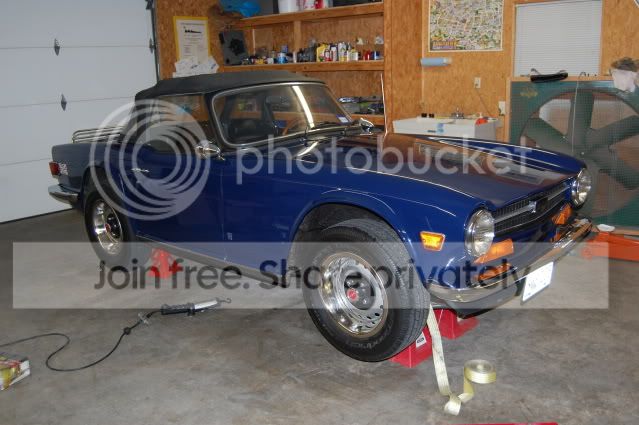

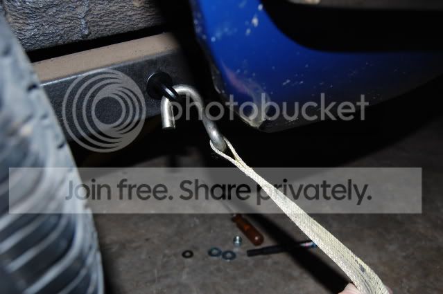

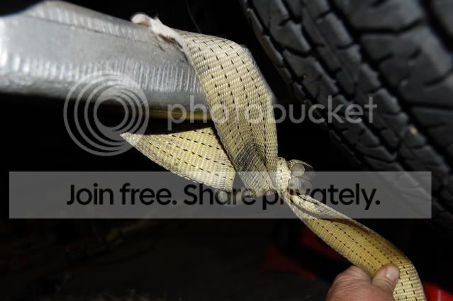

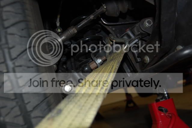

Don't have tire slings, so here's a few pictures of the best ways I could figure out to attach the straps to the wheel area so that the car can still bounce on the springs. The car is up on jack stands making final checks before the big trip to Regionals next weekend. I can cross the rear straps. Also a picture of the newly installed and painted eye bolt that I probably won't be using.
I like having a soft mounting on the car rather than metal hooks. I use axle straps outboard over the rear axle.
