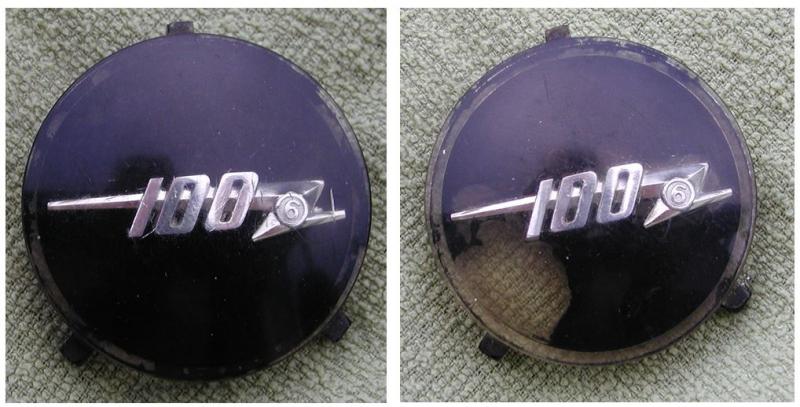

If you want to go the re-build / purchase route, two places you could try, I have personal experience with Curt (First link). He did both my adjustable 100-6 and 3000 trafficators, they came out excellent! I also have a couple hard to find non-adjustable original 100-6 horn pushbuttons that I'd be willing to part with if it would help you. (See pictures below.)

duane, thank you for the offer, but I have those parts as well as the part the horn button and spring fit into. it is all the other stuff below the horn button that is broken up!
Thanks,
Duane

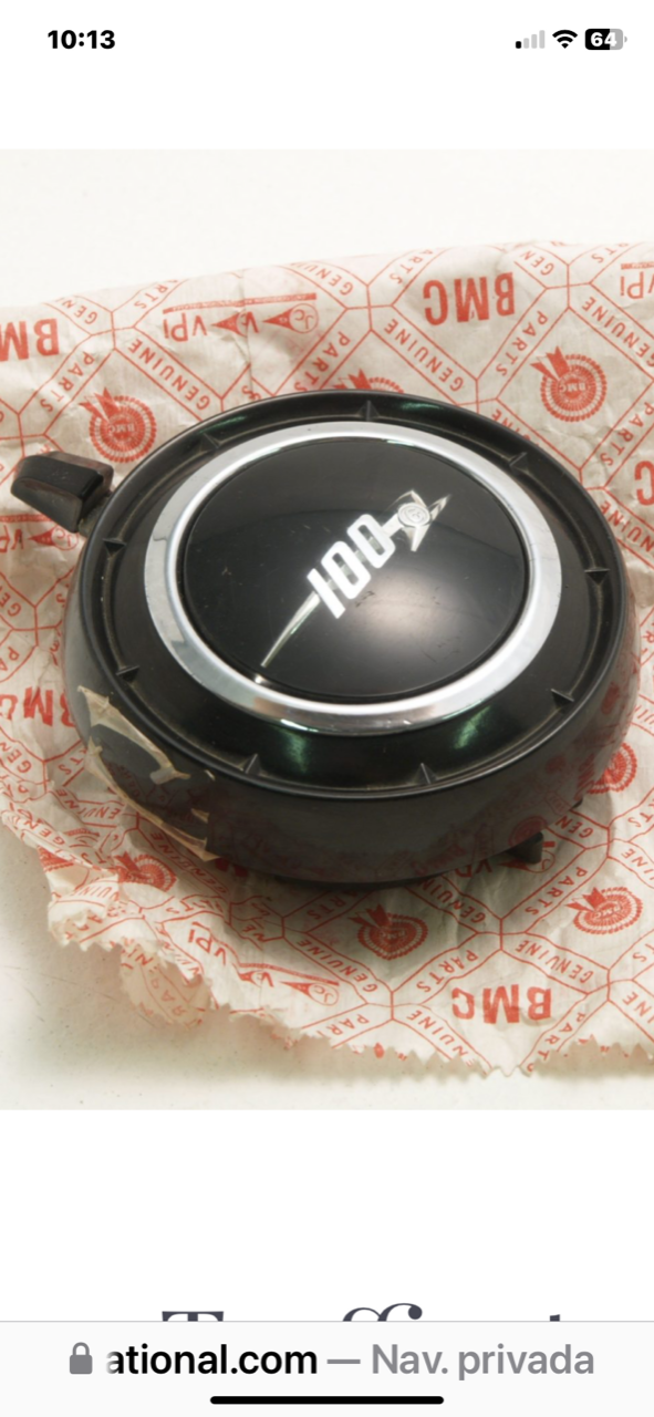

Hi,
I'm having a hard time getting a non-adjustable trafficator assembly. The question is:
Is it possible to change the steering to an adjustable one?
I wait for your answers
Thanks
