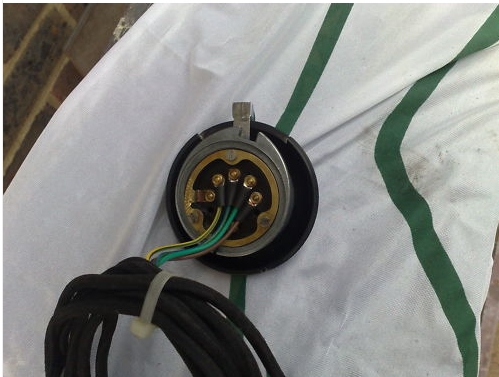

OK wiring gurus, riddle me this:
The BJ7 wiring diagram says coming from the trafficator stator tube there should be (1) solid green wire, (1) green w/blue tracer, (1) green w/yellow tracer, and (1) brown w/black tracer. However, the new unit actually has (1) green w/yellow, (1) green w/red, (1) green w/brown, and (1) brown w/black.
Two of the four match, but how are the green w/red and green w/brown supposed to connect? By the way, the connections coming out of the new wiring harness match the wiring diagram. Anybody else run across this problem with new replacement units?

The bn/bk should be the ground for the horn...
Determining the others is simple enough; one (1) of those wires should be common when the switch is in either the RH or LH turn signal mode (read this with an ohm, or continuity meter). The two (2) remaining wires will be the return from the RH or LH switch position.
Just mark up your wiring diagram to match how you connected it, for future reference.

Horn is brown/black.
Left (driver's side for LHD) turn signal is green/red.
Right turn signal is green/yellow (the BJ8 diagram says green/white. I'm assuming that's your green/yellow wire).
Green is the power input from the fuse box to the turn signal switch.
The wiring diagram for BJ8s shows that the turn signal wires change color when they pass through a Lucas connector on their way to the turn signal lights. That's fine, but it was very confusing when my new turn signal harness wire colors did not match the wiring diagram. I finally figured out that whoever made the harness assumed the wires were the same color from the lights to the switch.
Thanks for all the help guys. I got it figured out with the help of my handy multi-meter. If anyone else runs up against this problem the green/red wire from the trafficator hooks to the green/blue in the wiring harness. The green/brown from the trafficator goes to the solid green from the wiring harness. The green/yellow goes to the green/yellow and the brown/black goes to the brown/black.

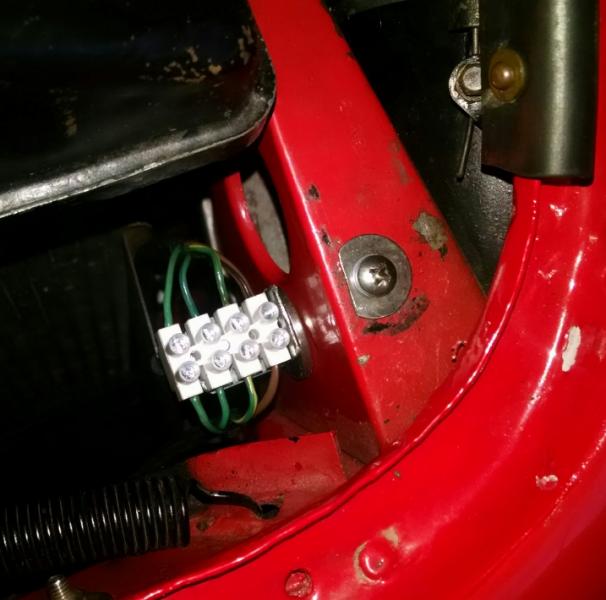

Posting this here for future access.
My usual method of pulling the trafficator wires through the stator tube involves unsoldering bullets #2 - 4, then attaching a wire to #1, shrink tube around the wires, then pulling them through. With my recent steering issues, have had to do this several times lately. What. A. Pain.
Came up with this non-concours way of simplifying the process. A molex connector was added about a foot back from the bullets. Wire ends were tinned and the bullets left permanently plugged in to harness. On the trafficator side, the tinned ends were wrapped in shrink tube and easily pushed through the stator tube.
Upper wires go to stator tube and trafficator; lower wires to bullets.
Connector attached to strut with rare-earth magnet for ease of removal for radiator air baffle access. Mine is covered by my upper air baffle, but it could be painted black.
I've never had to un-solder any of the bullets; it's been a while, but I'm thinking that they were staggered. I do seem to recall folding one (or two?) of the bullets backward (180* bend in the wire) and taping them down tight.
I've never gone through more trouble than to just tape a lead-wire to the bundle when pulling the harness in or out. Six inches (6") of wire tightly taped into the bundle is plenty secure to guide them back in.
