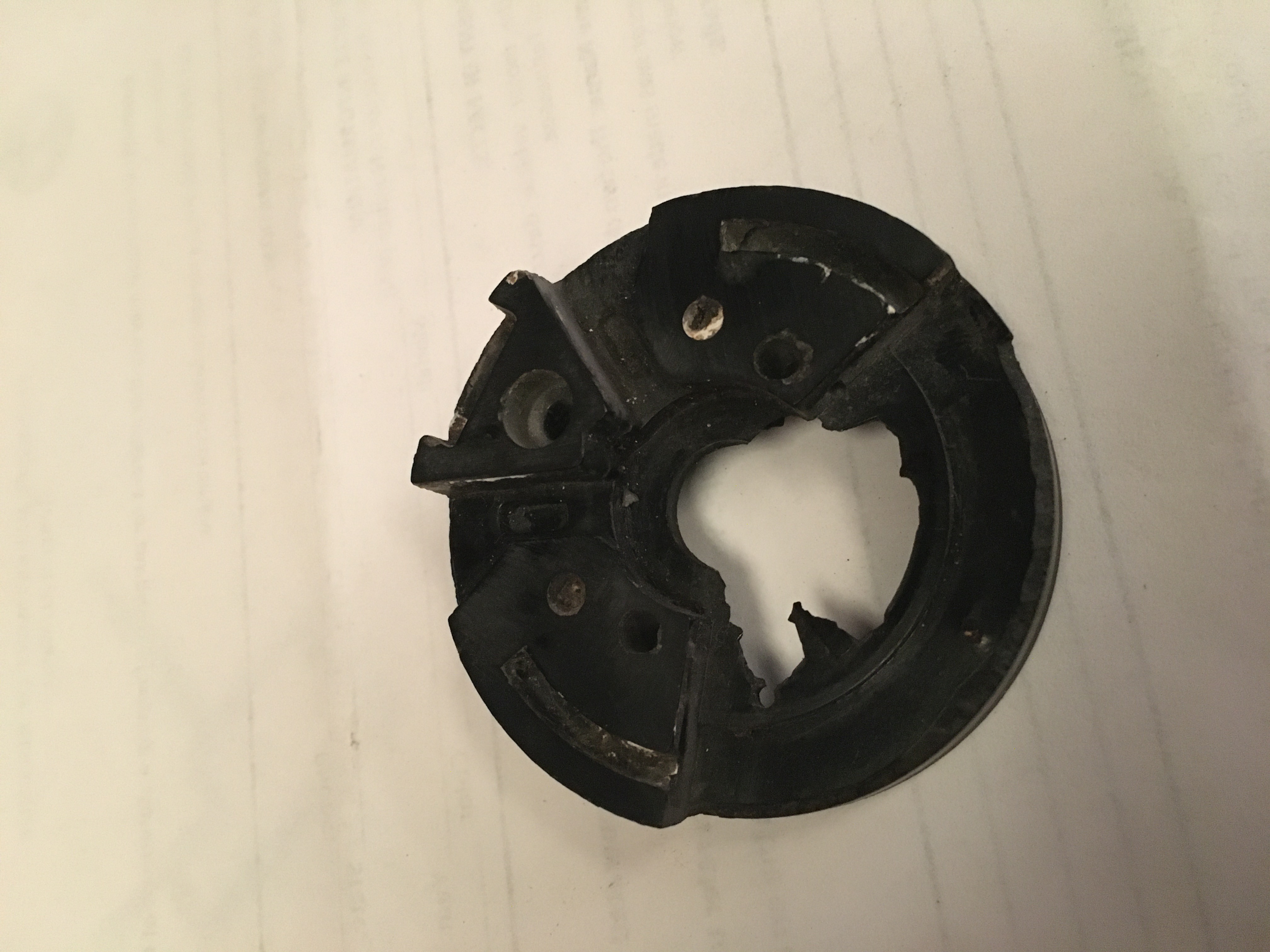

I started making the stator tube and was going to test fit the head unit to see how the slot fit. The slot is a little tight but the part of the head that it slides into is a little rusty so I decided to take the head apart to clean that part. Once disassembled I discovered the broken base part that the wires connect to. All the pieces are there but broken out. I am sceptical of new replacement parts if available so I am considering casting my own part. This does not look to be a difficult part to cast but I am going to have to come up with a good part to make the mold. I am sure I could find one to purchase cheaper than making the new part,but like the entire restoration project there are opportunities to learn new skills. Any advise is appreciated. Frank
Frank, I had a similar situation with an NOS part from a Standard Vanguard. The lower half had cracked apart but I used super glue to hold it in place, then JB Weld to reinforce where the stress was. Its a spare so never installed but works fine on the bench. You may be able to salvage yours, but I see yours broke where all the contacts are. There is room at the back to build up the reinforcing material.
