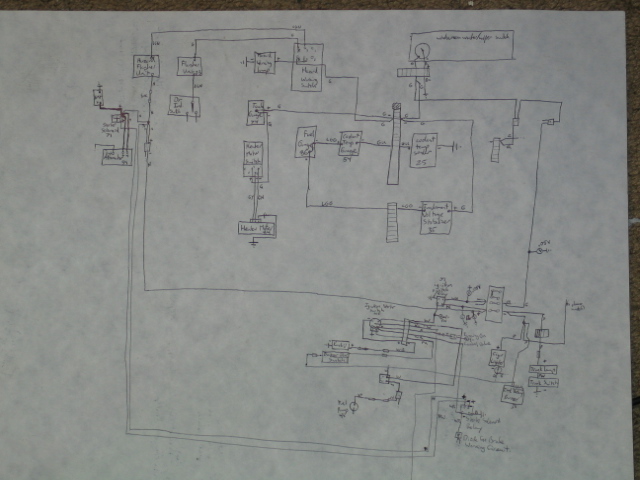

I was getting so frustrated this past week! I couldn't make heads or tails of the wiring diagram in the back of the Haynes manual. But then I started copying over the diagram onto a separate piece of paper by hand. Boy am I learning a lot! I think I've reached one level closer to Nirvana, too! /ubbthreads/images/graemlins/smile.gif
Anyway, my problem is that quite a few of my guages aren't working. Temp, fuel, tach guages are no go, as well as the wiper motors. If you look at my diagram I made in the attachment above, you'll see that power comes from the battery/alternator to fuse #4 in the fuse box (brown wire), to the ignition swith, back to the #3 fuse in the fuse box, then through all the things that don't work that I've already mentioned. In other words:
+--wipers--#3fuse--IGN--#4fuse--BAT(positive)
+--VoltageStabalizer--fuel--temp--Ground(negative)
+--tach--Ground(negative)
But here's the thing: Using my multimeter I see that all the brown wires (between BAT and IGNITION) have 12.5V while all the wires for my faulty equipment only have .05V with the ignition key turned on (0.0V with ignition off).
Alright, I know what you're thinking. "This is all way too complicated for me to help." I guess that's probably true, but if you have any leads on what a common cause of guages to go out would be, please reply.
PS I realize how bad the quality is of my graphic. At least it gives a vague idea of what I'm up to...

First things first. Relax...crack a cold one. Feel better? K. check the fuses and the fuse block itself (these are notorious for being a PITA. clean and tighten ALL grounds. visually inspect harness for for damage. odds are you have a bad ground. Check your switches.
Do you have 12 volts coming off the ignition switch going to all things inoperable? Perhaps the swith has failed? the way i understand your post is you have 12 volts to ignition switch but not leaving the switch. is this correct?

Yaaaaahhhh!!! I found the problem! The Ignition Relay Switch (the black cylinder attached to the inside of the right fender) was bad. Instead of using that to get power to my guages, I tried hopping over directly with a spare piece of wire. My windshield wipers immediately started to wipe! woohoo!
The moral of the story: Redraw the important parts of the electrical diagram. It was my understanding of which wires go where that gave me the final clue.
