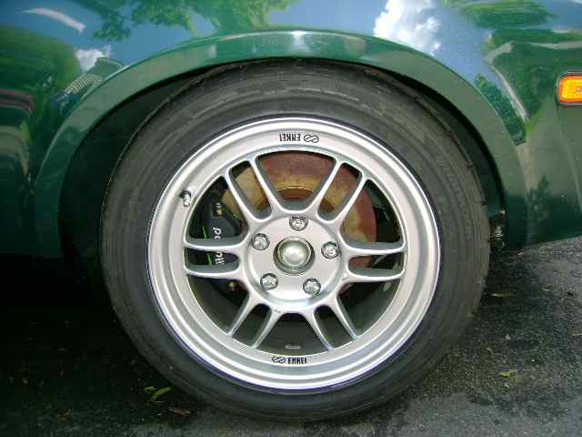

Here is my solution. I know it's overkill. Shortened Rover SD1 strut tubes wheel bearings, and hubs redrilled to a wheel friendly 5X4.5. 16X7 front and 16X8 rear wheels(wish I had gone bigger), Koni adjustable shocks, coil over spring perches, enormous sway bar, new ball joints, new tie rod ends fitted to a manual rack, poly bushings. Welded the subframe and installed larger grade 8 bolts. Added Willwood calipers and modified Jeep Cherokee rotors.
