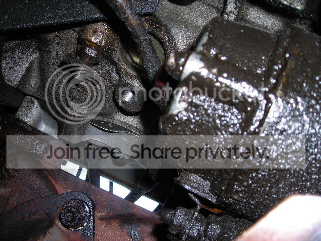

With the info Mickey posted though it brings up another possibility. If your sending unit is on the external pump then those shiny threads could be to a plug for the oil gallery. Especially if they moved the sending unit to that area. If that is what was there and it fell out it would be an oil geyser.
You could always fill the sump with oil, disconnect the distributor so it won't start, and turn it over until you get oil pressure. Then see if oil is coming out of that hole or out of the sending unit. Cranking RPM shouldn't spray the engine bay anymore but should identify the leak area.
That hole is a hole to nowhere. It is a mounting hole for the Range Rover engine mount. They are only found on 4.0 and 4.6 liter motors. You can see the bolts that are for the cross bolted main caps in your photo, so you have a 4.0 or a 4.6 motor in your car. The oil pressure switch is mounted near the filter on the timing cover. It appears that not all of the oil is fresh on that block. It may have been leaking for a while without you knowing. It also looks like you have a power steering fluid leak. The hard lines are prone to wearing as they rub up against the oil pan. Even more so once there is an oil leak and road debris starts to stick to the lines. The sand particles act like sand paper and speed up the wear process on the hard lines. Good luck.

I'm probably chasing my tail here, but those shiny threads REALLY bother me. With all that crud from the oil and P/S system, how come the threads are so clean? Seems like SOMEthing was there, and not now. Might get your guys to check that, although with their interest and experience, I would imagine they will on their own.

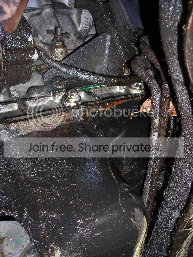

That's a lot of dirt and a lot of oil...
I suspect that there may be too much crank case pressure, and that it's blowing out the oil pan gasket. This can happen when the PCV valve becomes stuck.
It can also happen when the bolts holding the pan in place are too tight. They should be snug, but not cranked down (generally speaking), because the pan has a tendancy to warp, allowing oil to seap out.
If you look at the second picture, in the center are two bolts. The one in the block has no oil dripping off the bottom, while the one holding the pan does have oil dripping off the bottom. Not conclusive evidence that it's leaking from the oil pan gasket, but enough to make me think that could be the problem...

Yes, those clean threads are strikingly clean and suspicious, but the boss around the opening is not washed clean. The area around the oil pan that rlandrum points to does look suspiciously cleaner than its surroundings.
Appreciate the tips! I wiped the front of the oil pan off to see if the filter was leaking, but didn't wipe any other sections off.
