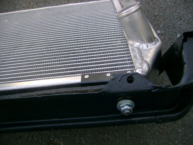

You can still get the correct formed hoses for around $50 a piece.- OR- The outlets are standard GM sizes. Top hose is 1.5" at both ends, and bottom is 1.5 at the engine and 1.75 at the radiator(if I remember correctly). In a pinch, go to any major auto parts store and ask to look at the hoses. Take your damaged hose in as a guide. Match it up with what is there. Usually you can find a similar hose to what you need. Just have to make a cut somewhere in the hose and splice back together with a change in direction to match what you need. I've installed universal radiators in half a dozen TR8s that way using $12 hoses from all sorts of cars. Problem with most universal rads is that the outlet on the bottom points upwards preventing the use of the stock TR8 lower hose. The TR8 rad has the outlet pointing straight out. Here is a pic of the $189 universal rad I just put in the wife's TR8. You can see the angle of the lower outlet which necessitates the "custom" hoses. Good luck with the new purchase.
